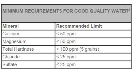

Water’s ability to corrode metal can vary considerably depending on its chemical composition. Chloride, for example, is commonly found in tap water and can be corrosive. Facility or tap water should not be used in liquid cooling loops if it contains more than 25 PPM of chloride. The levels of calcium and magnesium in the water also need to be considered, since calcium and magnesium can form scale on metal surfaces and reduce the thermal performance of the components. (See Table 2.)
Table 2
MINIMUM REQUIREMENTS FOR GOOD QUALITY WATER2
If you determine that your facility water or tap water contains a large percent of minerals, salts, or other impurities, you can either filter the water or can opt to purchase filtered or deionized water. If your facility or tap water is relatively pure and meets recommended limits, it is still generally recommended that you add a corrosion inhibitor for additional protection. Phosphate is an effective corrosion inhibitor for stainless steel and most aluminum components. It is also effective for pH control. One disadvantage of phosphate, however, is that it precipitates with calcium in hard water. For copper and brass, tolyltriazole is a common and highly effective corrosion inhibitor. For aluminum, organic acids such as 2-ethyl hexanoic or sebacic acid offer protection.
Table 2
