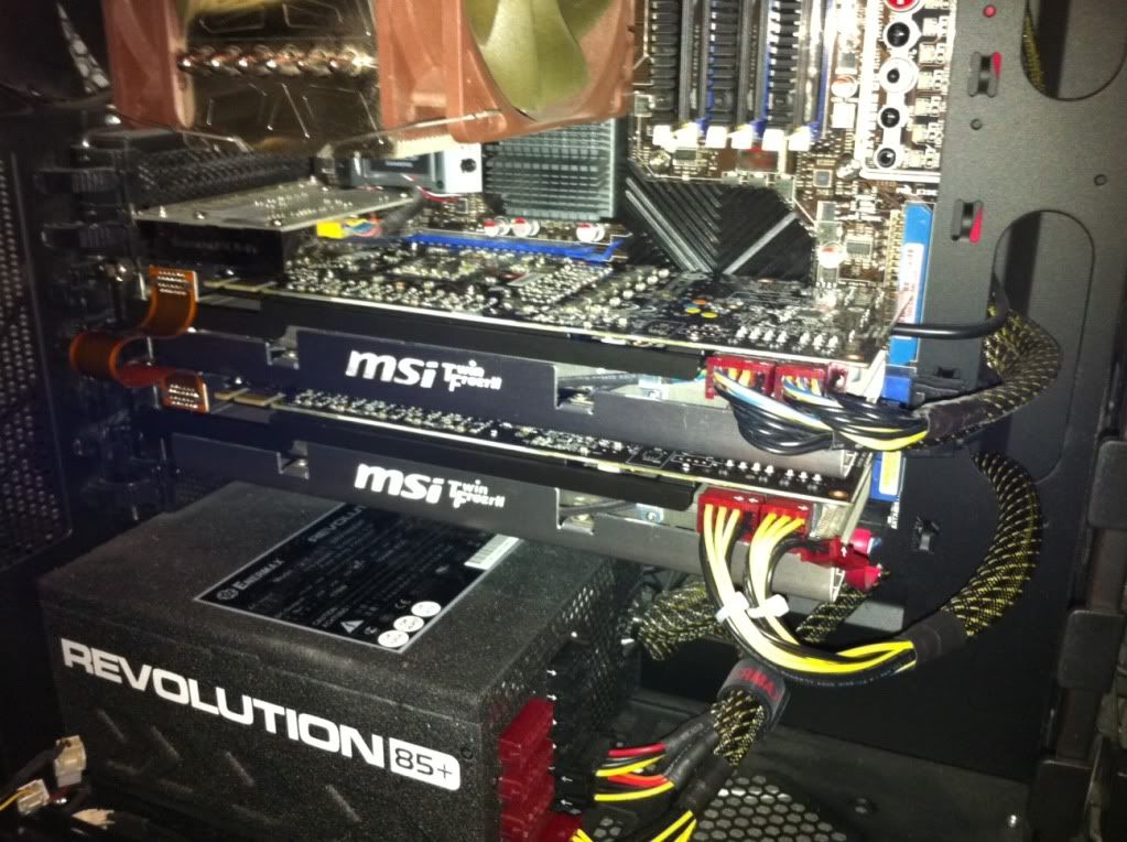

Just bought 2 x 6970 cards to replace my 2 x 5870. Between the 5870 was around 7-9mm and the rear intake vents.
As seen from the photo, the 6970s have 1mm spacing and no rear intake vents.
This would essentially cause them to overheat very easily AFAIK?
I would have tried the 3rd PCIE16x slot, however the Corsair PSU does not allow for a card of this size in that slot.
Any ideas or thoughts?!?
I have taken the cards out, and not even attempted to turn the machine on with them in to avoid any potential overheating damage.
i i have the same, i cant use the bottom space due to the pci-e slot being only 4x, my top card is about 10-15C hotter ive managed to make a 3mm gap by wedging something between them, but not 100% happy either
Turn it on and check the temps, can't see them overheating.
If at idle temps are acceptable then try a game, again monitor the temps with MSI Afterburner, then if you're unhappy either sell one or you could get a new motherboad with better spacing?

Motherboard spacing won't matter surely? This is the ATX form factor and the PCIE slots match with the spacing on ATX compatible cases.
Plus this is the Cosmos S case (aka huge) and a Rampage II Extreme Motherboard, which is built for this!
that looks like pciex16-pci-pciex16-pci-pcie
you get boards with pciex16-pci-pci-pciex16....
Surely your 5870s would have had the same spacings? I've got a 5870 in my PC now, and a 6950 next to it, and both cards are identical in size and shape.
5870 has a tapered end which allows the fan to suck air through an aperture of around 2cm diminishing to around 1cm.
The 5870 also has rear intake vents, the 6970 is totally sealed.

Personally, i would get a bigger case or look into liquid cooling
I had to learn this the hard way aswell, I had to sell my 800D to upgrade. Not much you can do, not sure if there are better dual slot aftermarket coolers out there, but by the time you buy them, you might aswell get a new motherboard or case. Motherboards with 3 x 16 slots are becoming more common, i got the haf-x case because it has 9 pcie slots from when i had 2x 5770's (in my old case the temp difference was nearlly 20degrees). I since then upgraded to a 580 with xtreme plus and i got the option i adding another one with ease and temps will not be a prob cause it idle's at 28 and while gaming only reaches 41 at 20% fan speed.
I have a similar issue on mine atm (same case and MB) but im am using 580's.
Top card is between 10-30 degrees hotter than the bottom which maxes at 60ish under load.
Toyed with the idea of a new case to use the bottom pci-e slot or a new mb with better spacing, but in the end im in the process of putting together a water cooling build.
