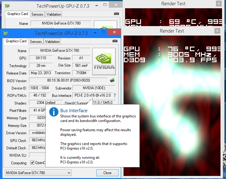

I got it in a pci-e 3.0 slot although it picks up at 2.0, and in boot up it says GEN2, even though i set it at gen3, i also read that there is some registry patch to enable 3.0 but that didn't do anything, its a asus x79? rampage formula motherboard (bf3 edition)
no idea why it wont do 3.0 any ideas?

When you use the patch you need to reboot afterwards for it to take effect.
http://www.techpowerup.com/downloads/2148/nvidia-geforce-kepler-pcie-3-0-mode-enabling-patch-for-sandy-bridge-e-systems/
When you install drivers it removes the patch so you have to re install that as well.
I installed that patch ran it as administrator and restarted it but it still shows as 2.0, I put the gfx card in correct slot, i checked with manual..does having windows 8.1 effect this ?
I don't know, I use win7
I know it is stating the obvious but have you got PCI-E 3.0 selected in the bios.
Failing that it may be a GTX 780/mobo thing.
