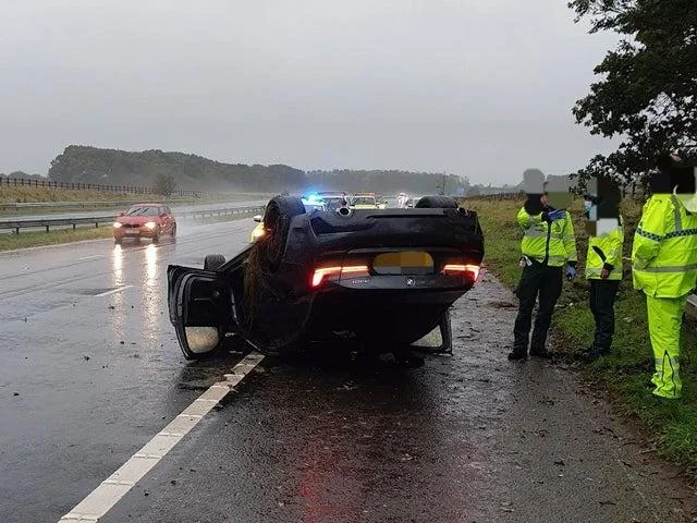

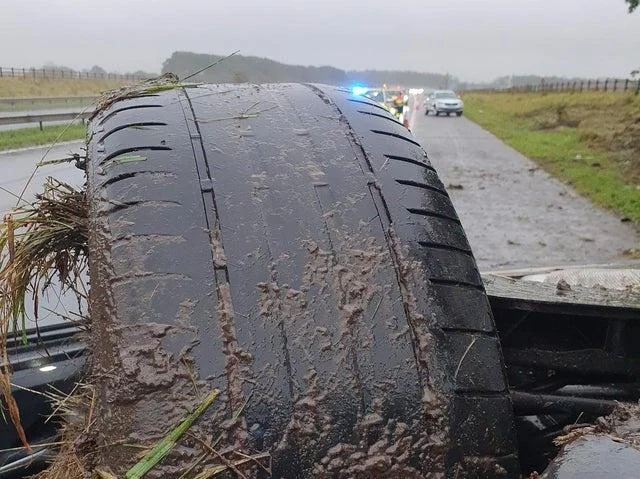

An officer from Lancashire Road Police tweeted: "Car had aquaplaned, struck the barrier in the central reservation then onto the nearside grass verge where it overturned. Thankfully no injuries. Reason for loss of control was soon obvious - lack of tread on rear offside tyre."
Article
Hmmm... I'd hazard a guess it was more than simply a wheel slipping which caused the accident.
Drive to the conditions people.
