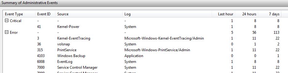

Since installing a couple of games yesterday, I keep getting random hang ups, a couple of blue screens etc.
I've run event viewer and I get this....
Now I'm not sure whether this is GFX problem, PSU or what so I was hoping someone might know where to start!
I've updated the drivers for my Radeon hd 7800 and it hasn't solved it :(
Any help much appreciated :)
Do a DDU uninstall and then reinstall the drivers.
DDU?
Kernel Power is just the PC shutdown unexpectedly. Install BlueScreenView this will list more information about the crash.
