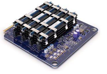

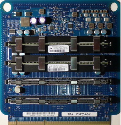

Unfortunately, the generic heat spreaders on my new memory do none of that. They are designed to give no resistance to air flow what so ever. Imagine airflow being from left to right on this picture (which I borrowed from some site, but it shows the difference perfectly):
