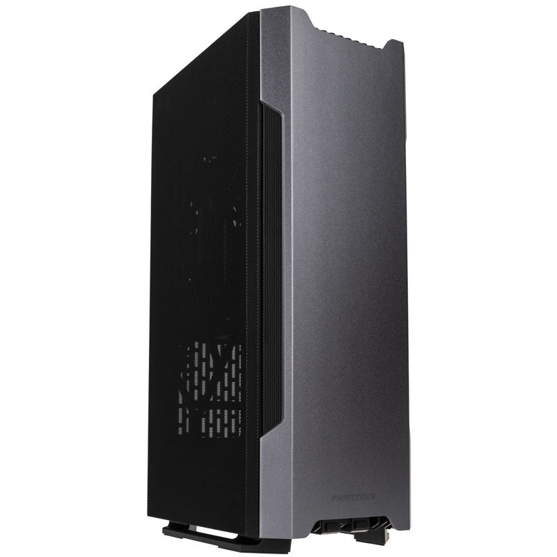

When I do ITX specs, I usually go with the Phanteks P200 because it is simpler (e.g. supports ATX PSU), but it is a relatively large case.
Doesn’t that phanteks one expand to allow for a 240mm cooler?
The last one in your spec (Shift XT)? Yes, but so far as I know, the thickness issue I mentioned still applies. @mickyflinn might be better placed to say than me, but I believe the Arctic is one of the thicker AIOs and runs into trouble in a few cases.
The case can take a 240mm aio but I wouldn't go for the arctic it's rad is thicker as @Tetras mentioned but the CPU waterblock can also interfere with components , especially on itx motherboards.

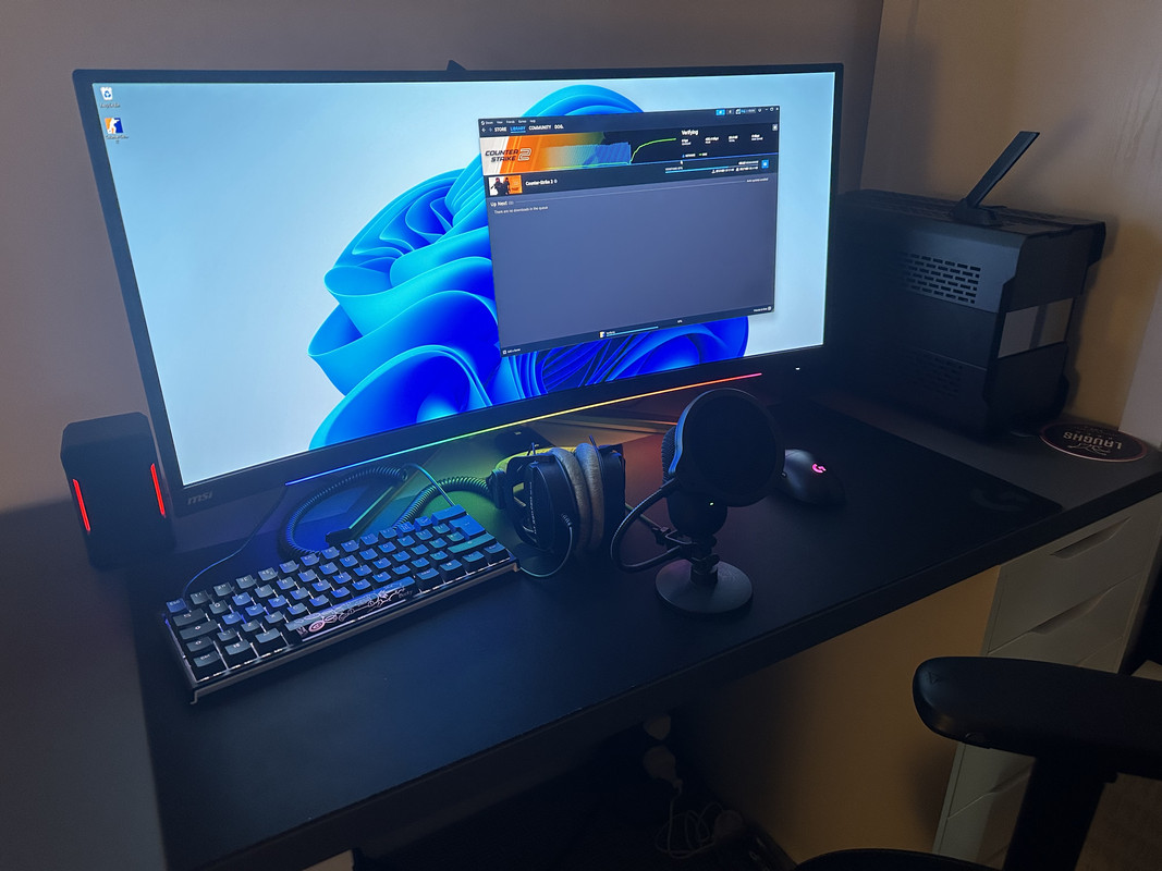

Thank you for the advice above, appreciate it. Ordered all the components over the weekend should be here today/tomorrow! Gone for a 1000w corsair SFX PSU & EKWB AIO 240mm cooler (made sure to check the thickness as suggested in here). Also gone for the MSI 34" QD-OLED monitor. Hopefully my 3080 will hold up until the 5000 series comes out :D
Up and running :D
