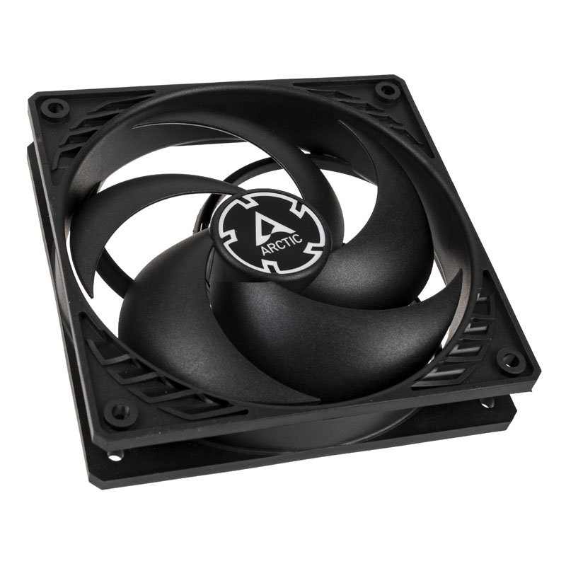

Probably has stock 3 case fans; 2x 140mm (probably in side) and 1x 120mm (probably in back).
I would put 3 120mm bottom intake fans (3x Arctic P120)`fans for £5.99 each:
Remove all back PCIe slot covers to increase rear vent area for better rear exhaust airflow. Setup bottom intakes so they speed up as GPU temp rises.
Even without a better CPU cooler this will likely keep it from crashing.
