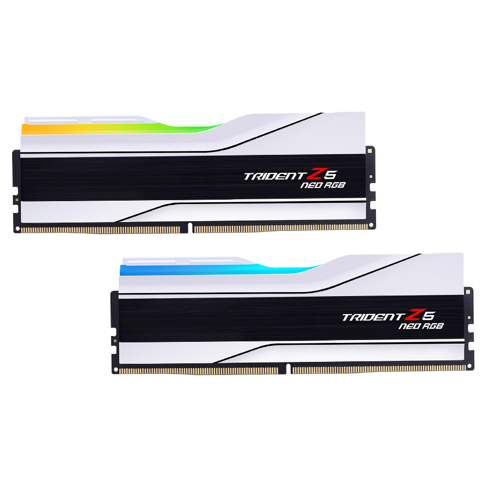

Not sure if 64gb is overkill or if 32gb is fine.

32gb of memory is enough for gaming unless you running modded games, grey ram .

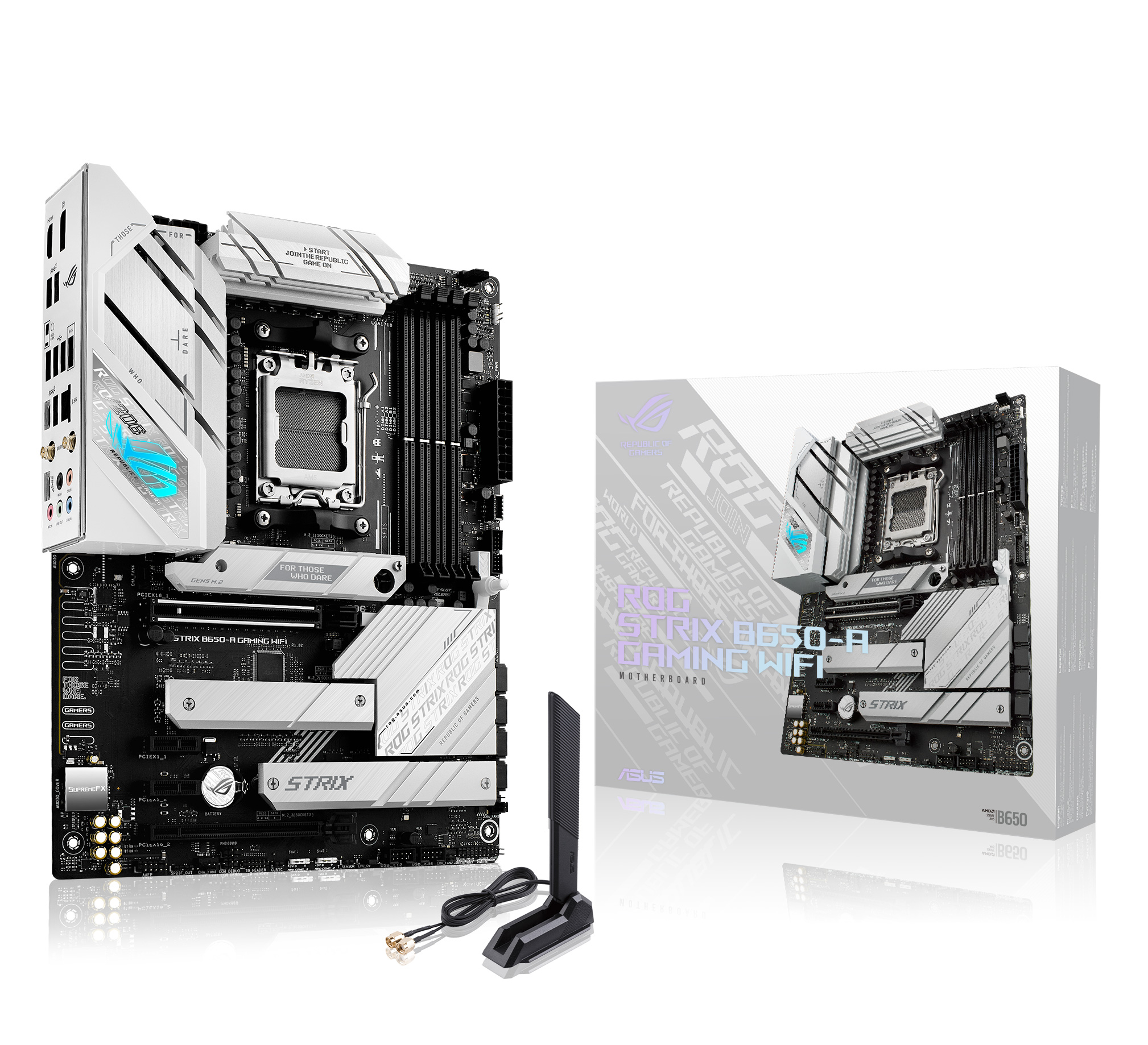

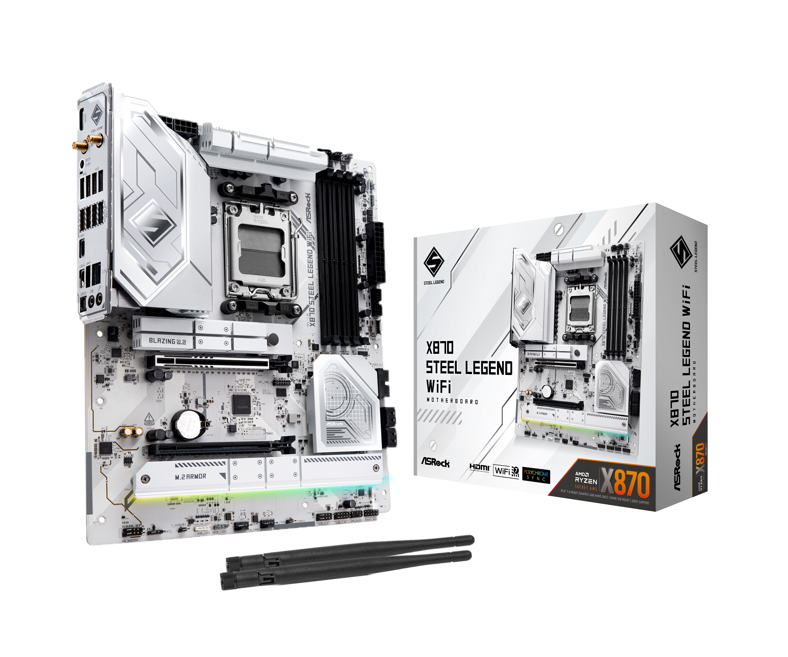

£200 for that motherboard which is only pcie4 , x870 boards have pcie5 as standard.

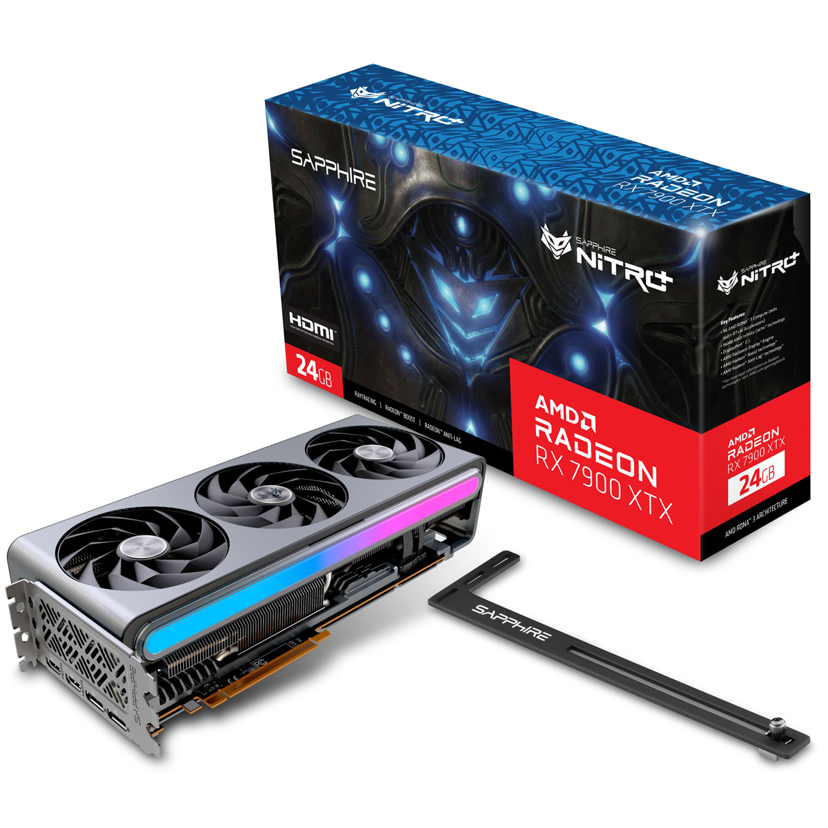

No more fans needed especially as ith the 360mm aio at the top, go for which GPU you want but before you decide read reviews look at comparison between the 7900xtx and 4080 super .
You have to get them to quote you so ask Overclockers mite be able to source you a white GPU also so it's worth inquiring as there part of a bigger group I believe.

Many thanks for the advice everyone - going to give them a ring on Monday and speak to them if they are open.Leaning towards the xtx just because I’m feeling traumatised by the Nvidia nvldmkmm message I’ve been getting haha ‍.Seriously though guys thank you.Side note but changed the display Port and cable and had a small screen with aida64 showing temps etc,removed the screen thinking is it that causing the display issue - still crashed.Removed aida64 and no crashes for 3 hours.Might be the cause of might just be having a lucky day but set on a new rig now.
