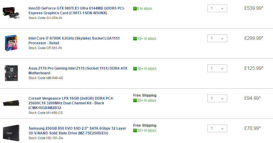

Thoughts on this? I'm not sure the Mobo will handle the M2 drive though, the amount of SATA ports should be enough for my planned selection of drives + I think PCI will be good.
I'm not sure how well my current PSU will handle a TI, its a 650W Antec semi modular one and over 4 years old iirc. If I get a new one I want to make sure it can handle 2 TI's. Otherwise I'd just upgrade whenever I get a 2nd TI
