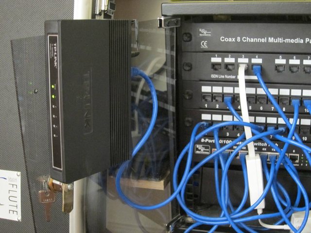

Hi,
Following on from this and this thread a while ago...
I was looking at upgrading our home network to a gigabit one as my cousin recently got a Netgear NAS and although it has two gigabit ports going to his switch (it is a business use one lol) he said it is really fast so I thought I would look into speeding ours up if it doesn't cost too much
Our house is wired up with a switch downstairs and RJ45 wall sockets around the house (pics at the end of this thread). We did not install this, it was done when the house was built so I didn't know if the cables were Cat5 or Cat5e, my cousin said gigabit will only work if it is Cat5e so today I tested it
This is how it normally looks on my PC when I have a switch connected to the wall plate and my PC into this gigabit switch:
So I assume that just says 1Gbps as the connection between my PC and the switch upstairs is
If I connect to the wall plate directly this is what I see:
And then I took my gigabit switch downstairs temporarily, connected my PC directly to the wall plate, and connected that wall plate connection downstairs to my gigabit switch and got this:
From that last image, it is 1Gbps so am I right in saying the cabling is Cat5e?? That was with just my PC upstairs connected to the gigabit switch I took downstairs, so going through the cable in the wall rather than direct
So I then thought I'd get the NAS, and also connect that into the gigabit switch to test the speed to see if the money would be worth upgrading to a gigabit one. I tried to transfer some files, about 2GB, and non gigabit (current setup) it took 4m52s, whereas with the gigabit connection, my PC going through the cable in the wall and into the same gigabit switch as the NAS, it only took 1m30s :D :D
So I was just about to buy a gigabit switch for downstairs, 8 port TP link one, same as my 5 port, just bigger but then I thought I'd try it just once more
Tried the same transfer, same files, only difference is that I had maybe (can't remember when I done it) added a cable from the old switch to the gigabit one so I could get internet on my PC. This time it was taking ages again so I checked the settings on the PC and it had gone back to 100Mbps ... Hmmmm
I removed the cable from the old switch linking that and the gigabit switch, restarted the NAS and my PC but it still showed up at 100Mbps. Why is this? I had it going at 1Gbps as shown in the pic above then it changed.
Anyone able to help? Would be appreciated :D
PS: Currently with this setup the NAS is connected straight to the router (BT Homehub 2, non gigabit capapble) so we will move the NAS and connect it to the gigabit switch when we get it. Am I right in saying that within the house then, transferring things to and from the NAS I will not need to go through the homehub 2 so that won't affect things? It should run at 1Gbps within the house then 100Mbps if I use remote access from outside the house somewhere?
Thanks in advance :D
Pics...
EDIT: Also, will it be okay to just run a cable from the gigabit switch to the old non gigabit one, so we can continue to use that switch for things we don't mind being 'non-gigabit'? It won't run the gigabit things like PC's and NAS on the gigabit switch at a slower speed just because we have the old switch connected? Thanks :)
If I am reading the post right then the you need to just replace the 10/100 unit at the bottom of the rack with a new GIGABIT unit simple as that because the 2 units above just look like patchpanels.
Is this in your home or is it a work place?
Cheers
That is what I was thinking. But what confused me was how it was working at 1Gbps after moving the gigabit switch to test it, but then it stopped and went to 100Mbps. Not sure what made it change
Yeah the two above are patch panels and the numbers on the stickers relate to the ports in the rooms.
It is at home, so glad the previous owner/builder installed this! So helpful :)
Well the reason it went back to 100Mbps was you removed the GIG switch;), the router controls the speed of the network, the other other 2 units are just a patch panels. So have no speed control over the network.:)
All I can say is that it will make it so much easier to configure a network with that, ALSO just as a tip insted of just a simple GIG switch if funds allow why not look a a Managed switch:cool::cool:. This way you can keep an eye on the network from your PC, set up access if say one PC is a KIDS PC to stop unwanted browsing and to manage what they can use and can not onthe web and the network.:cool::cool:
This will also mean you have full control over bandwidth allocations for say streaming, Torrents, or anything.

I would do two things.
First, as Tezabeza said change the switch hub for a gigabit one. This will make your network a gigabit one.
Second, change the BT home hub to one with gigabit ports. If you nas is currently connected to the network via a non-gigabit router (home hub) then no matter how fast the rest is it is only going to pull data at the slower speed.
To me it as simples as internet then being passed to home network via gigabit and home network distributing connection between each other and internet as gigabit.
I must say though I am nowehere near any sort of expert on home networking but those two things would strike me as the first things to do.

Hi,
Sorry for the late reply
And sorry if I keep going over the same thing :p But are you saying I cannot just upgrade the switch? That is really what I wanted to do :p Even if I move the NAS connection from the router and put it into the switch ... the router still needs upgrading for the wireless devices to access it at gigabit speeds?
That router looks veryyyyyyy expensive!!! Haha wasn't looking at spending anywhere near that amount. Before that option is there not anything cheaper?! :D If there isn't I might as well try and get a BT Homehub 3 from BT, that has one gigabit port, run a cable from that port, through the patch panel and into the new gigabit switch we will buy and then connect the NAS and computers etc to that? Will that work?

If you're getting a new router, don't cheap out on it.
The only two I would consider (around the £100 mark) are..
Billion 7800N
Asus DSL-N55U (they've just added a ton of features to the firmware, including SNR tweak which the 7800N has too)
Or just get a new switch, something like a TP link 8 port or 16 port gigabit switch

Why do you need to replace the homehub?
Just get a gigabit switch and plug everything into this, the HH is fine for just internet use
Edit:
Exactly this...get an 8 port gigabit for your NAS/your self/brother/any other gigabit required devices and either use the 3 spare ports on your HH or use the 100mbps switch.

Are your laptops wireless-N? Decent machines?
Cheap - get a wireless N AP and plug it into your new gigabit switch
Expensive - get a new wireless router like the Billion previously mentioned
Yeah just checked in device manager and mine has a Dell 1510 802.11n card in it and my brothers is a bit older, but his is a Dell XPS gaming one so I assume it will be wireless N. Will check tomorrow
Wireless N access point into the gig switch sounds like a good (best I think) idea nobody has mentioned yet until now!!
Something like a TP-LINK TL-WA901ND? That is 300mbps ... Is that the quickest? Seems like a sensible price but Ive never bought an AP before
Then connect that (along with the wired PC, TV, PS3 and obviously the NAS) to the new gigabit switch ... I was thinking of a TP Link TL-SG1008D as mentioned earlier in this thread ... What is your opinion?
This sounds like a good plan! Thanks for your help! :D
How does an AP work? How is it connected to our internet connection if that makes sense and is it hard to set up? I have do some networking knowledge but am still in the process of learning at uni. Sure it can't be that hard to setup
