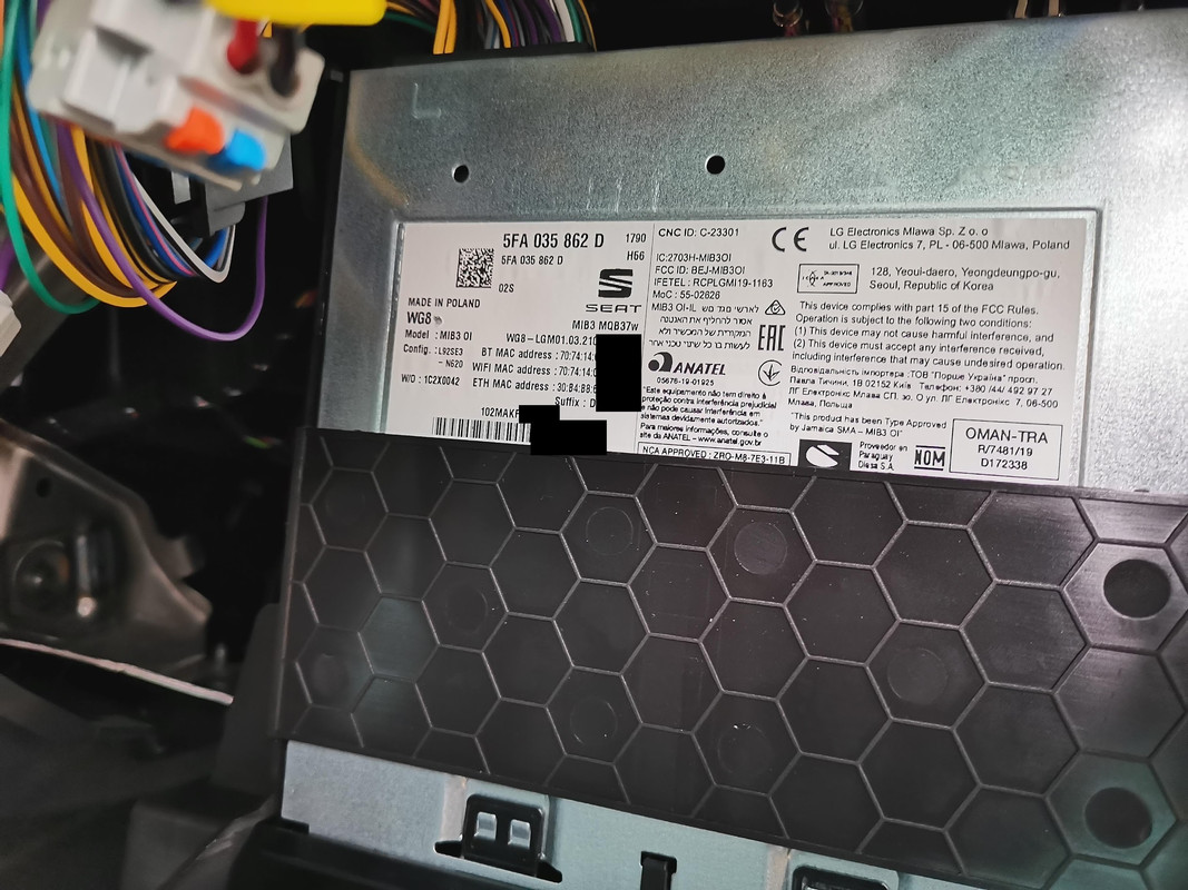

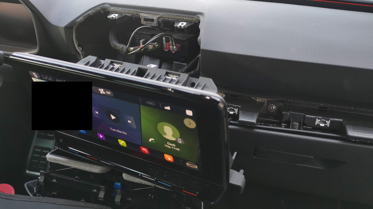

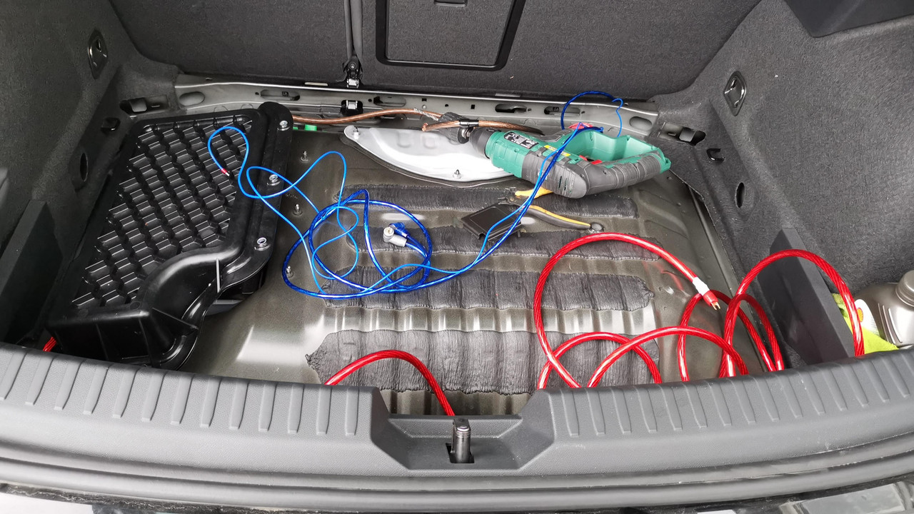

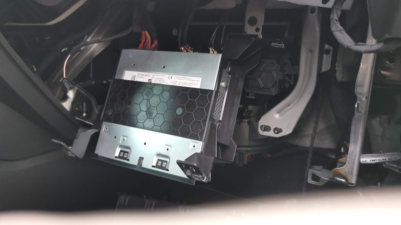

So I've done it, main annoyance is the HU is behind the glovebox and needs a lot trim removed to get to.
Helix parallel to the rear speakers is absolutely no problem, no errors on the computer or so, everything works like it should.
Surprise was the HU being in behind the glovebox instead of the screen and the battery being in the boot instead of the engine bay.

It's like they have secretly solved all of the issues that you'd come up against when doing jobs like this a decade or so ago would introduce.
Having the HU and screen separate ? it wasn't just a separate Amp with a digital feed from the screen, that nonetheless hides most of the electronics - like the BMW HK system.
it's pretty complex to have a bus for speaking remotely to a touch screen for sending display data and sending touch data the other way.

Aye, WIP:
