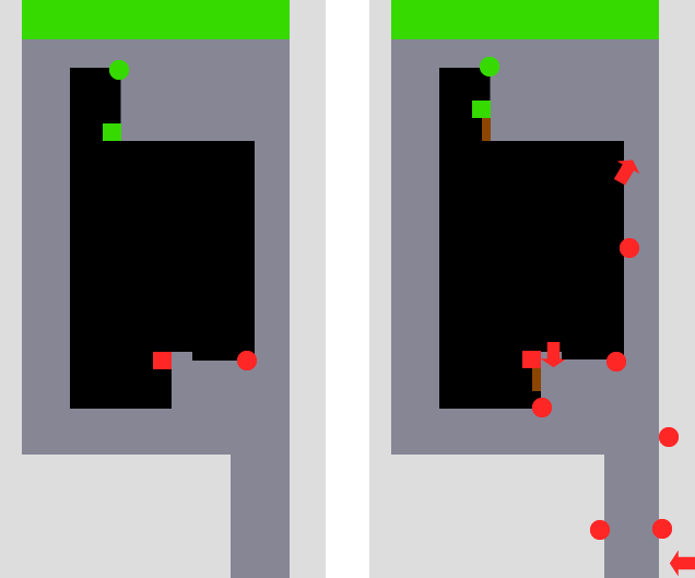

I've currently got two outside lights. One at the back of the house and one at the front. Both are controlled by a switch at their respective doors.
The front of the house is where we have the most issues so I'm going to do that first. We've got steps right at our front gate and there's not enough light to see where you're going. To the point where even though I've lived there for 3 years I need to pause to let me eyes adjust to see the first step...
Once you get up the steps/hazard that's when the PIR kicks in on the light on the front corner of the house.
Then... you walk past the light and get to the front door. Because you've just been blinded by the light, and the light is now behind you, you create a stark shadow on the front door meaning you now can't see the keyhole...
First world problems 101.
This is a rough sketch with before (left) and what I've got planned (right).
Squares are switches, circles are lights, arrows are PIRs.
Question is...
How can I wire up the switch and the PIR's so that when I turn on the switch inside the lights are permanently on, and when I turn off the switch the PIRs take over?
I think I just need to make the switches and the PIRs in parallel, but would that mean running all the PIR cables from the switch inside the house or is there some jiggery pokery wiring cunning I can do from the external wiring coming out to the single outside light already?
