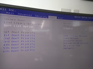

Hi,
I'm installing Windows 10 from scratch on a new Alienware Alpha, but I've never dealt with all this UEFI malarkey before.
What options should I use (UEFI vs. Legacy?). Should I enable secureboot?
I basically want to retain the flexibility of booting other things (e.g. Memtest, SteamOS, other Linux distros) and using multiple OSes, so should I just use legacy mode? What sacrifices would I make if I don't go all-in with UEFI?
Cheers,
Su
[edit] Additonal question; will my Windows 10 key still be "recognised" automatically if I don't use UEFI?
[edit2] NVM, I booted into the original Dell Windows install and use a program to retrieve the Windows 10 key - so I should be safe to just nuke that partition now, right?

Hi,
Thanks for replying! I wanted to install Windows to a different drive; I went with UEFI but secure boot off. Seems to have worked well (didn't need to enter a key or anything), so I had formatted the other HDD and will use as storage.
I feel like I missed a trick by not enabling SecureBoot though - is it possible for me to do that now, even though I installed Win10 with it disabled.
Cheers,
Su
No worries, easiest way is, try it and see, if it doesn't workout just go back into bios and set it back to off. I think it will work because I think it will have Microsoft's certificate preinstalled in the bios.
