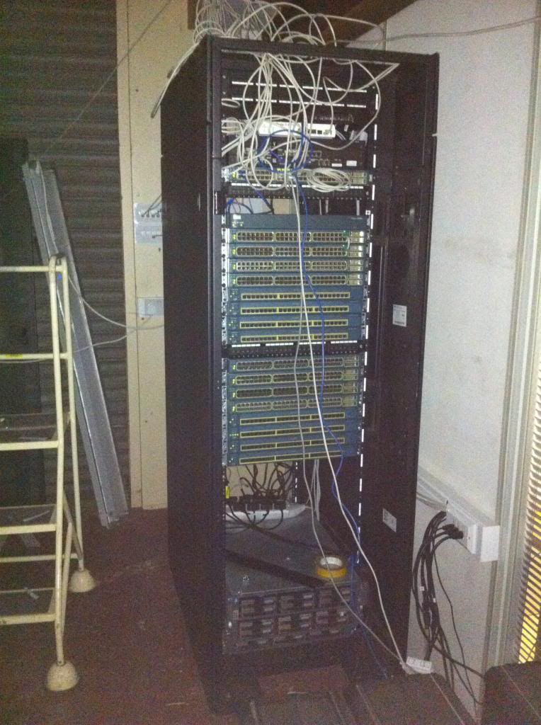

The solution has to be completely over USB with no direct human interaction, IE I must be able to teamviewer into a machine and send a command to a control circuit of some sort. The device(s) will be used to toggle one or two power switches inside of this rack mount:
The power switches are will be used to remotely turn our Cisco Labs on and off as required.

No offence but if you had any idea how expensive the true solutions for this setup were you too would be looking at fingers pushing buttons. Just to turn off two of the 18 devices would cost around £350, cheaper for larger setups been in the range of £1400 for all 18.
Why would we spend that when we can operate a perfectly safe switch?
Are you sure you have enough spare network ports there? :p.
