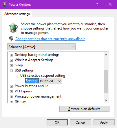

You could start with the following:
1. Untick any Fastboot option in BIOS.
2. And:
Not confident that'll be the issue in this case but good to rule them out of the equation. Can turn them back on later if there's another solution.
3. Can also go to Device Manager, expand the USB list, right-click on each and Properties, and go to the Power Management tab to untick "Allow the computer to turn off this device to save power".
