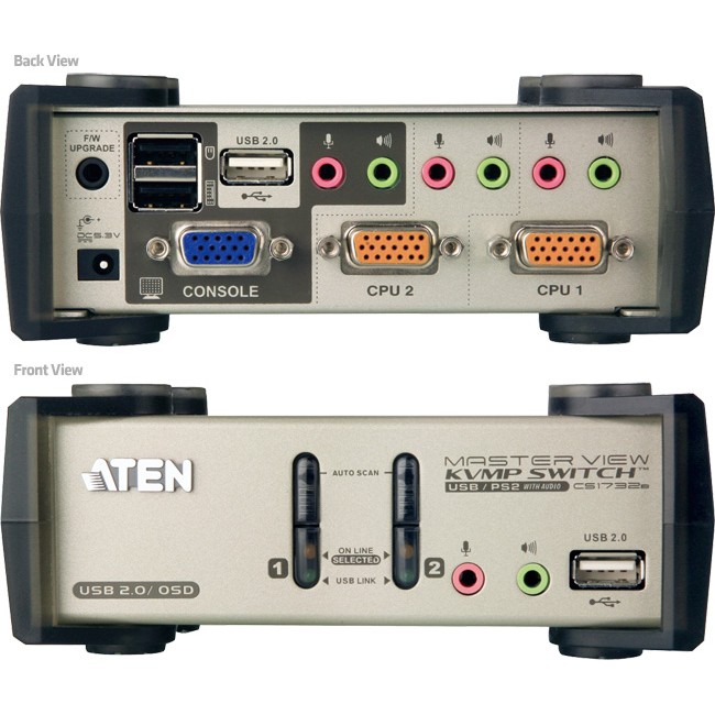

I have the same requirement, so I recently purchased an Aten CS1732B. It works a treat.
It has 4 USB ports. 2 of these are dedicated keyboard and mouse USB ports, so using them will install your keyboard and mouse as a generic "Aten Keyboard/Mouse" - meaning you won't be able to utilise any features unique to your setup, but it sounds like that's fine for you.
The other 2 USB ports (one on the front, one on the back) are standard 2.0 you can use for anything, so i'm using these for my keyboard and mouse instead as they're both Razer products and i still want to use them fully. In fact as the keyboard requires 2 USB slots (one for the keyboard, one just to power the backlights) i have the backlighting plugged into the dedicated keyboard port.
The switch costs costs about £70-£100 new, but you can pick them up cheap second hand on eBay. I only paid about £15 for mine. There are newer versions with DVI rather than VGA, but like you video switching isn't a requirement for me anyway.
The best way to do it is like Sartorialism suggests but its not cheap - I used a CS1784A - one thing to be weary of is that analogue audio (won't affect a USB soundcard, etc.) tends to lose some quality through these things :S
You should be able to enabled pass through mode which avoids keyboard/mouse emulation - not sure how you do it on that unit but probably the same way as mine:
Invoke HSM by holding down num lock, pressing and releasing - on the numpad and then releasing num lock (keyboard LEDs will cycle) then press F10 to toggle between bypass mode on/off or N to toggle keyboard emulation (probably best reading up on what this does before doing it). Pressing F4 with a text editor having focus i.e. notepad with HSM invoked will spit out current settings into the text editor.
EDIT: The manual on that model is a bit different - looks like you need to use the OSD to change emulation settings - while it mentions keyboard bypass is doesn't seem to mention how to do it in the manual that I could find from a quick glance.
