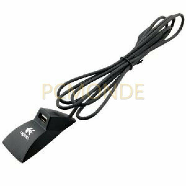

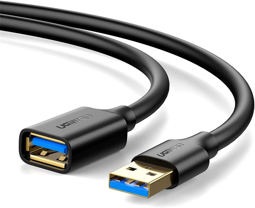

You might get away with a thicker cable, I had issues with my External DVD Writer ripping CD's no working on the long cable extension for Logitech receivers.
Bought uGreen USB extension cables and fine now but only about 3m so not sure if 15m is beyond the limit of non active.
