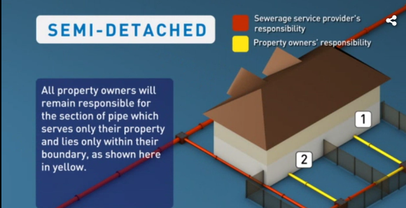

Not in most cases Jez - especially not if it serves more than one property. From 1 October 2011, the water and sewerage companies in England and Wales became responsible for privately owned sewers and lateral drains outside of your house.

It depends entirely on the type of property and whether anyone else connects into OP's pipe. For example if OP is in a semi detached and the pipe running down the drive is connected into by someone else the whole shared part is the water company responsibility and I'd be surprised if you got permission to build over it.

But the process of establishing ownership is far more complicated than just whether or not it serves more than one property. There's a whole boundary thing now, among other factors. We got a rather thick reference manual on it!
Depending on where you are, you might even find you pay one company for services facilitated by another water company's assets, so you end up talking to the latter instead.
End of the day, the advice is still - Talk to the Developer Services at your local water company, who will tell you *exactly* what the score is and what you must do (including any building standards).
