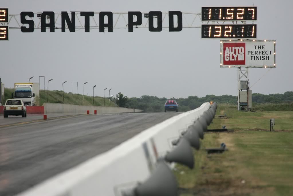

TOTB that has just gone had a good showing, with LET powered Tigra,Astra and Corsa taking the 1/4 1,2,3 FWD spots and the Tigra and Corsa taking that FWD top speed spots.
The Tigra trapped 128 1/4 :D
Nova's and corsa's can be savage with tuned C20LET's in. Friends could show my Evo a clean pair of heals without much problem.
in 11.27 seconds. Also took first place in the FWD top speed over 1K at 166MPH.

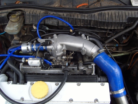

Here's one from when he was doing some pre-TOTB testing. Currently it's sitting just over 500BHP without Nitrous. Gas is installed and will be used soon!

That Tigra would be even better if the intercooler had some proper ducting and a bit more thought went into that airfilter positioning.
