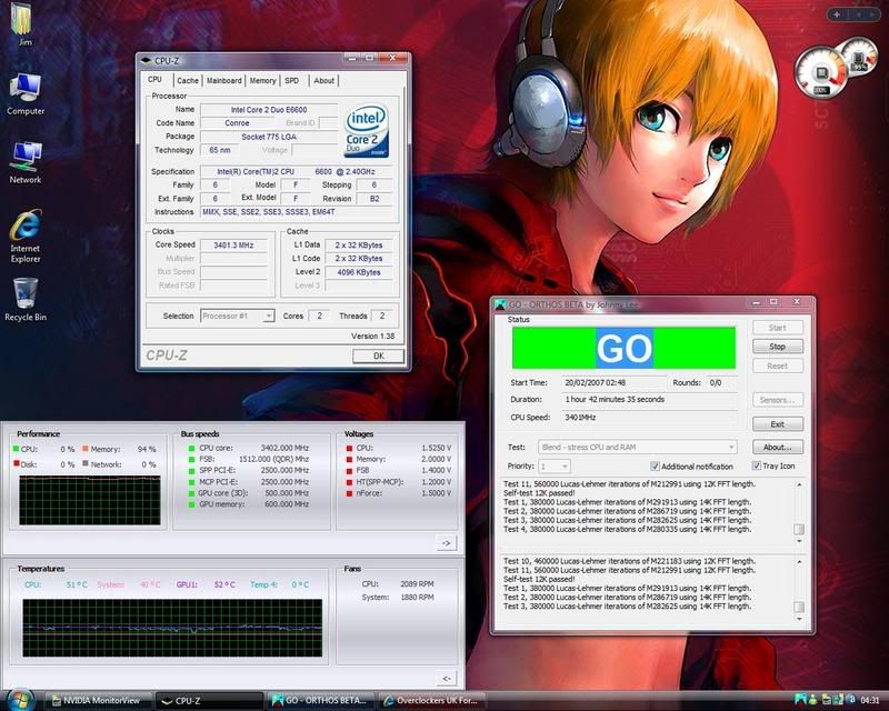

guess what!!!! success. mnow running prime 95, at 3ghz, at 1.30vcore with 53deg load temps. ummm

mine was setting itself at about 1.37v when it was set to 1.29 (all in bios, fails in dual prime 95 at any lower). its now set at 1.29 in bios and my temps have gone from 60 at full load after 12 hours dual prime 95 (small tft testing)
to ~53 under full load after the same time. Seems like an improvement to me!!
