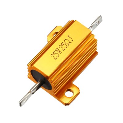

Another simple alternative is one of these metal clad resistors which can also be screwed to a metal plate as a heatsink but almost certainly will be cool without that.
