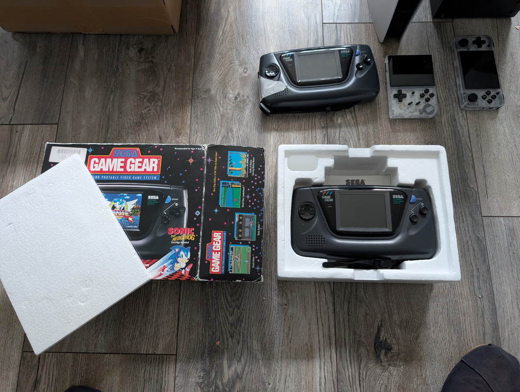

This week's toys.. massive box of pads and a few game gears, you don't see many nice boxed ones these days.
The only down side here.. the GG is a US model which means it's center pin pos where the UK model is center pin neg. The GG has no polarity protection so if you put a wrong polarity DC jack in it will smoke from the main 9v transistor on the power board so ideally I'll convert it to a UK model before selling. But then it's less original but it needs a re-shell anyway so it will probably go full mod... Watch this space I guess.
