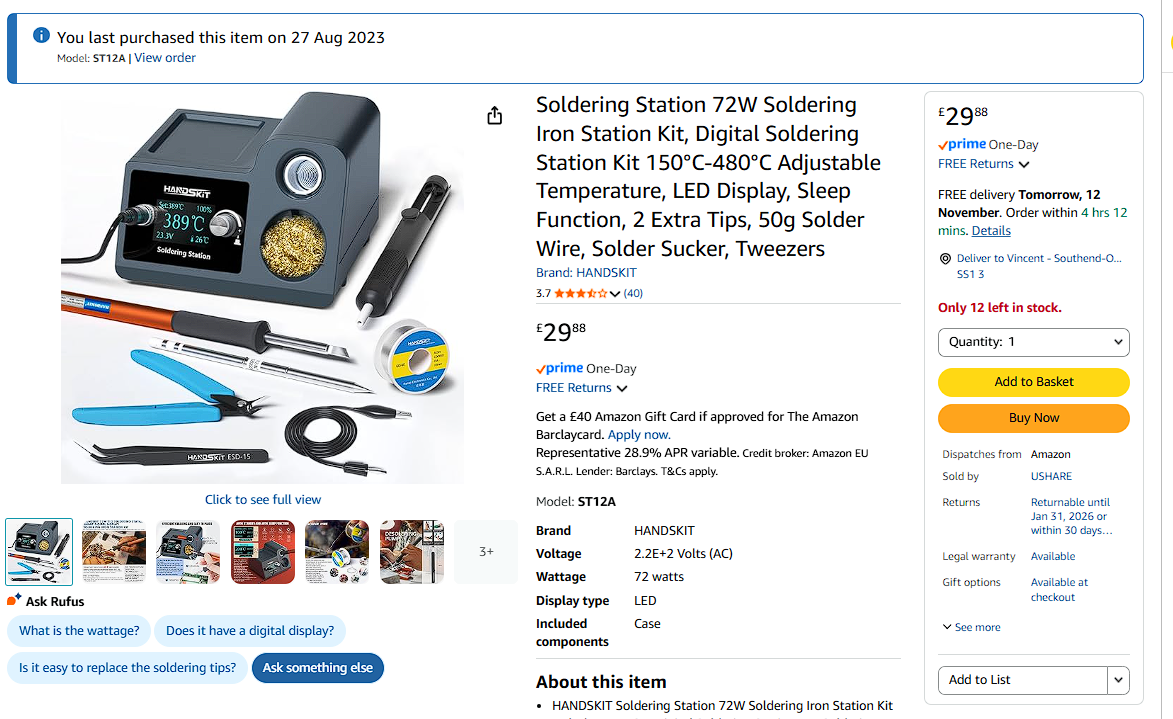

Do you have a budget yet not crap soldering iron you recommend?
I have recently thrown away my £50 one as I'd set it to 400 degrees C and the leaded solder still wouldn't melt - Must have been broken.
been using this one since Aug 2023.... love it and its still going strong. For the price its a very good iron.
Everything that comes with it bar the t12 tips is junk but the iron is a copy of the Hako t12 station and is very decent. You can use t12 or t15 tips in it.

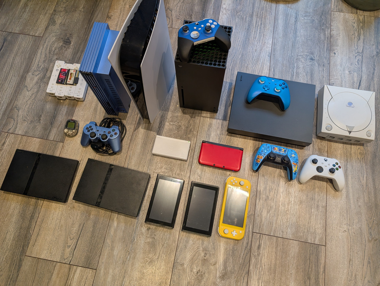

Had a switch today with a fault that was different!!! An inductor was kohms across when it should be a dead short (ish) swapped the inductor and we good. Not one ive seen on a switch before but hey ho... I'm about 12 switches in now and so far so good, I haven't come across one I cant fix yet but there is a very rotten pink one that's water damaged, ain't nobody fixing that...
So far we have fixed:
- about 12 switches
- 1x ps5 digital
- 1x series x + Pad
- ps2 aqua blue fat
- 1x One S + Pad.
- 1x 3ds
I would say we are doing pretty OK so far, still plenty more to do but a good chunk of it is fixed and sold already. Happy days.

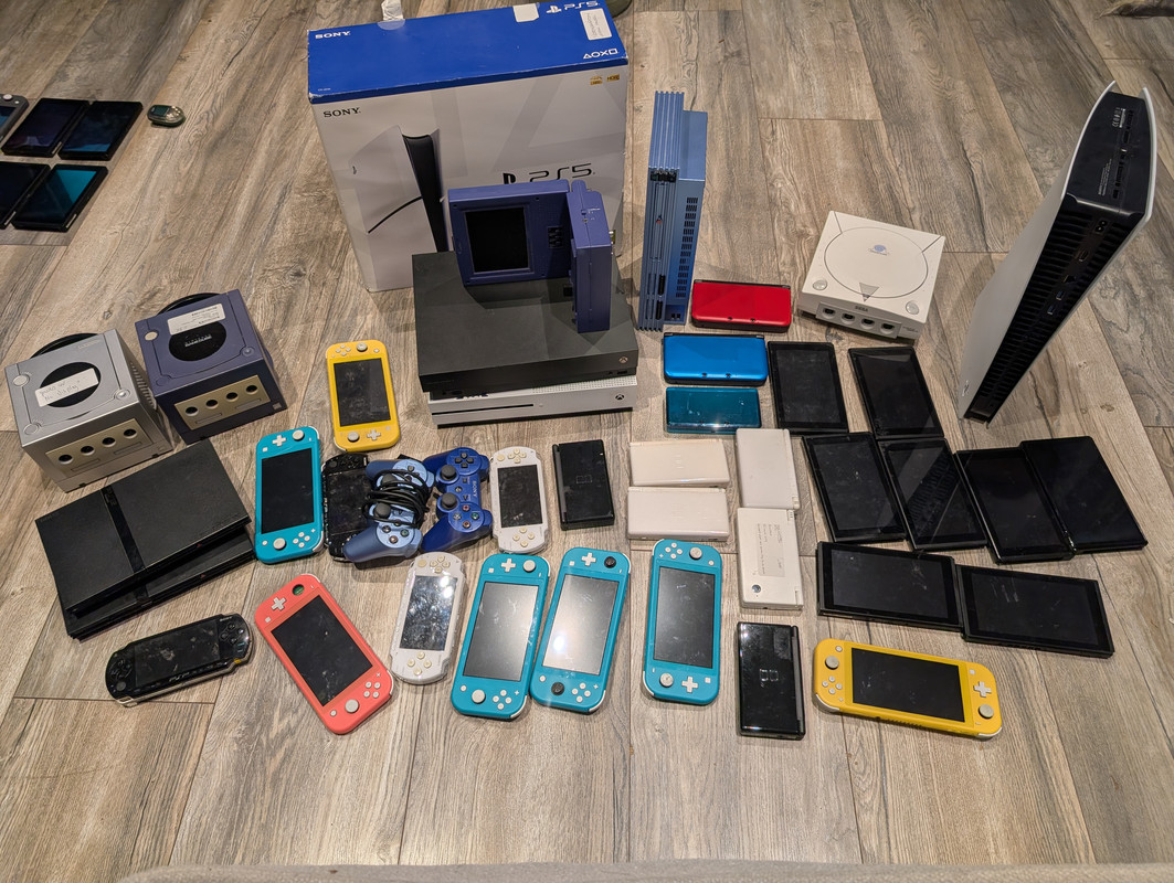

Little pile of fixed stuff to get gone...
Got some other stuff out on the bench to get through as well. Probably get to some fixing today and listing tomorrow most likely.
