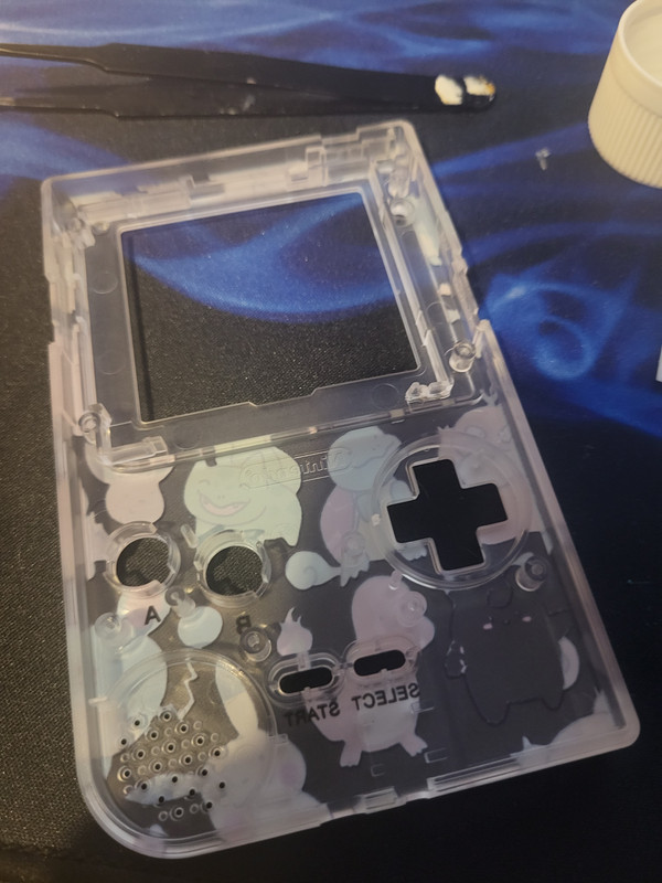

Thats handy as the Lynx was a send in :) Its a bit ropey on power and the screen is grim! We shall mod a lynx tonight! Least that way it can go back to its owner tomorrow! Last night I fixed a GG! Just gave it a quick recap and screen is good so buttoned it up with a new lense and called it done. I might go mad and mod all of these and just stack em up to all be listed at the same time - We shall see!

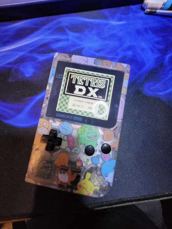

Agreed on the Lynx though the Pokémon gameboy shells are very cool!

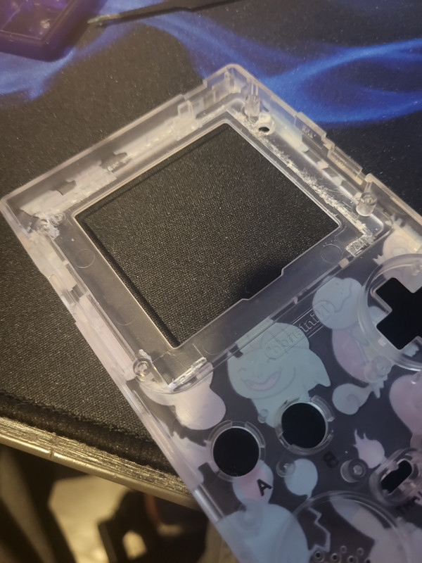

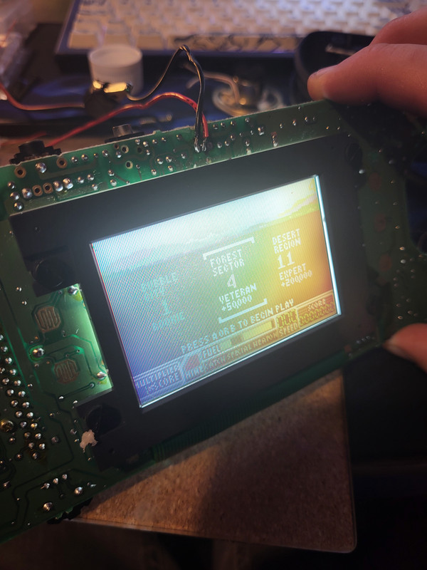

We will then remove the 34v rail and its current dc converter board as well as all the old cathode ray tube screen etc, fit up the LCD, new lense and have ourselves a grand old time... Was a bit disappointed as the Lynx mk1 has a tendency to get long screw damaged on the front case when baboons take them apart and attempt to put them back together. This one is sadly no exception and has a damaged front case which is almost impossible to find or repair nicely. So it will be a nicely modded lynx but with a sub par case. But unlike everything else you see here it isn't my console so I shall just do what im being asked to do and mod it!

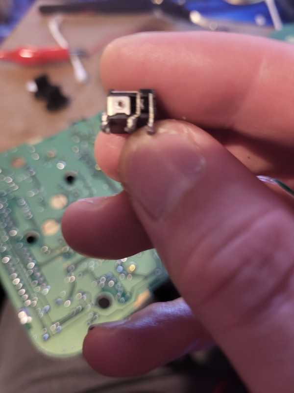

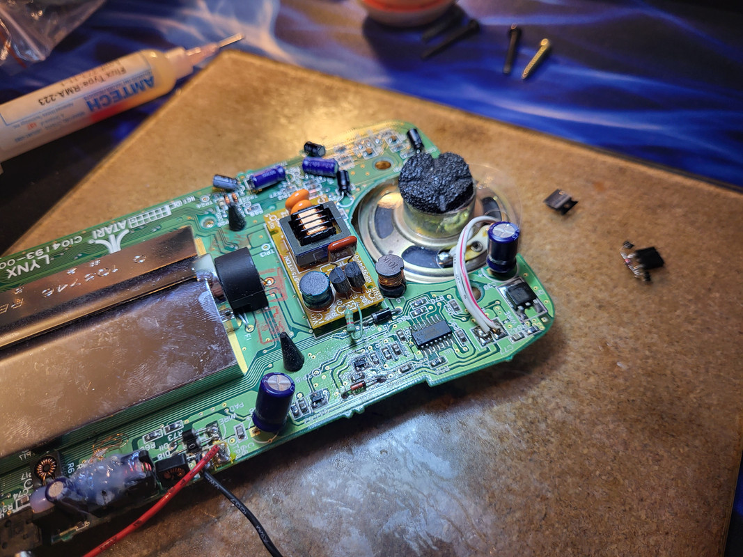

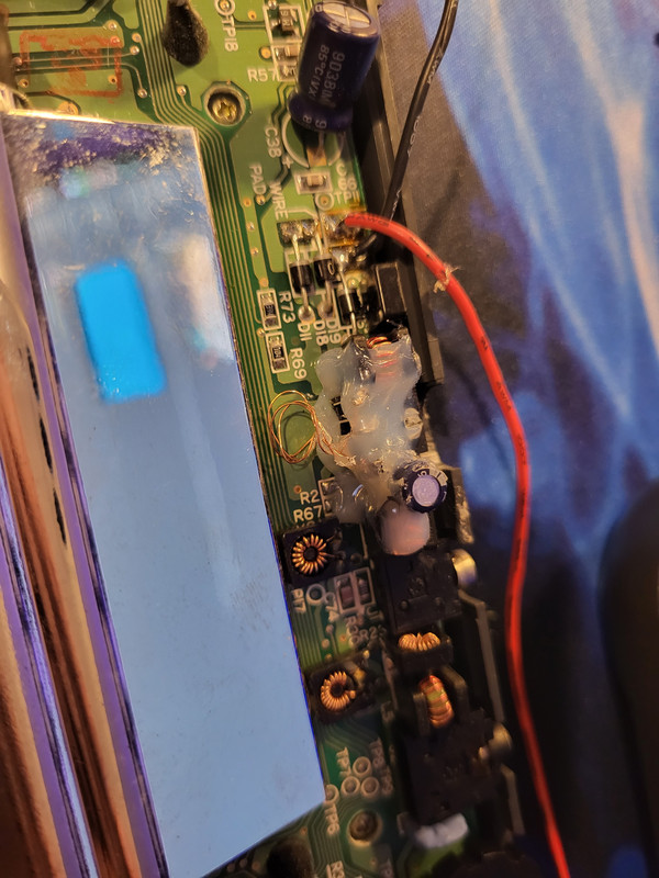

Right so opened her up and immediately this is what we have, a dc jack massacre. The jack is the incorrect jack and is glued to the board with 3 wires running from the jack down a via to the through hole pads below. more on this later as it comes back to bite us... Anyway....

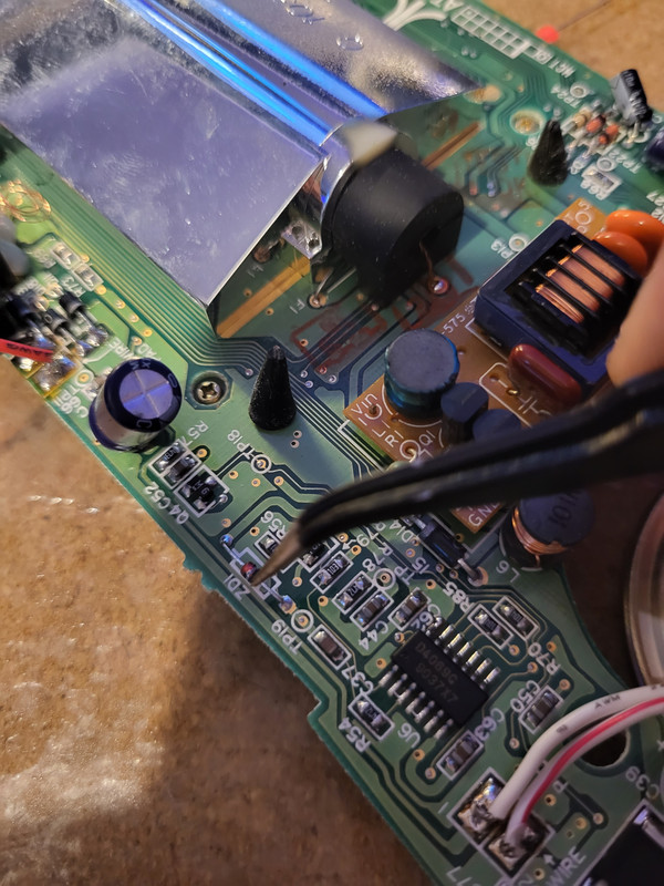

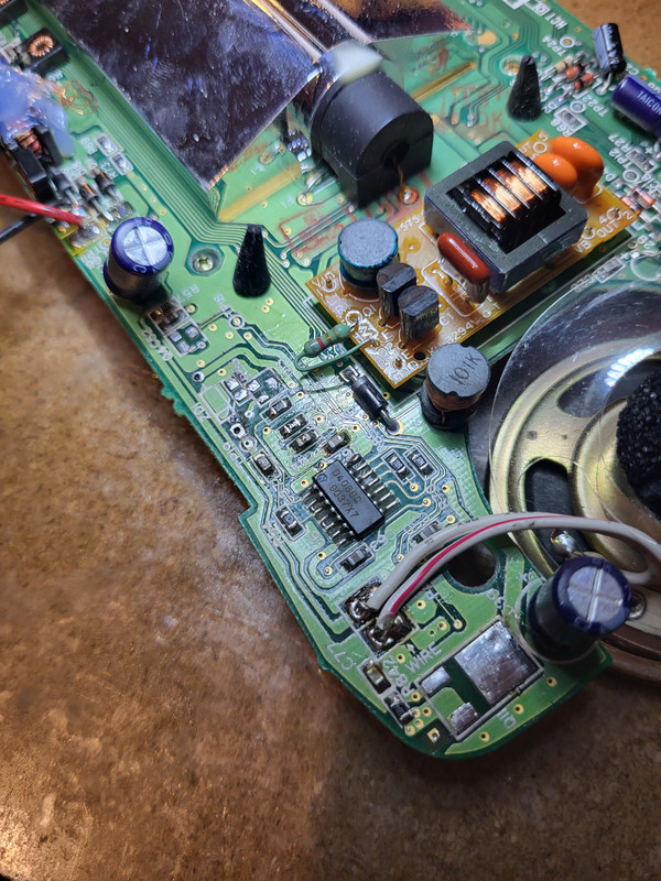

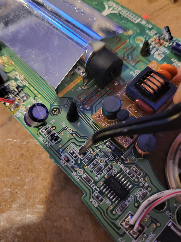

The parts to rebuild power circuit so we may as well start here...

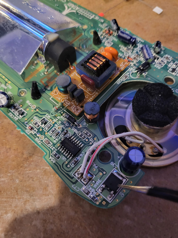

Main fet, we will replace this:
And this transistor:

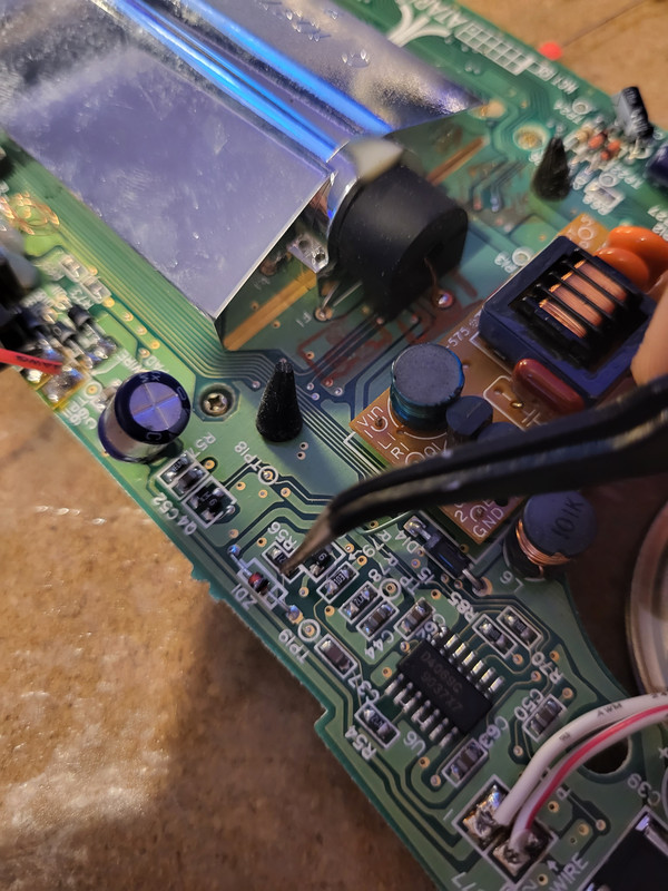

This resistor
the zenner:
And this bad last transistor here:

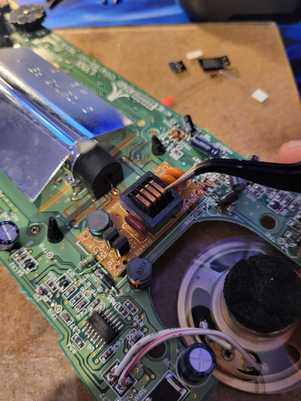

Eventually we will also remove this and a load of other parts but first lets rebuild the power circuit and see if we can't get it booting and reading games consistently first!

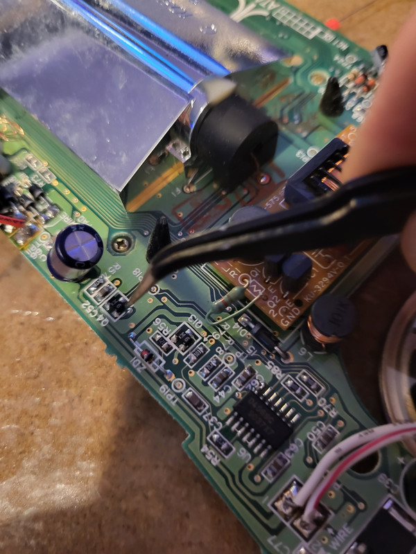

Power circuit removed...
New power circuit installed :)
And this is where it gets interesting, fired it up, same issue, so decided to investigate further. First things first, the lynx power circuit is almost the same as the game gear and fundamentally there is a switch in the dc jack that when you insert the jack it disconnects the battery circuit so you don't get the batteries getting power when the AC is connected because you will almost certainly have a bad time anyway the glue blocked the switch but also the jack was wired up wrong so the switch was effectively on the wrong side of the jack. I'll try and find a schematic so I can explain better. Anyway removed it all the glue and the bodge wires and soldered some wires directly to the Lynx jack side and success, she boots first time every time.

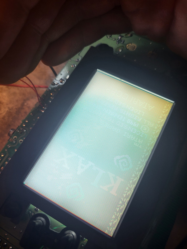

This is probably the worst screen ive ever seen on a lynx, there is something wrong with the resistor array that feeds the contrast wheel which means its only settings are bright and stupidly bright but that's fine because im going to rip out and disconnect the contrast wheel from its resistors and wire the mod directly to the pot you will see what I mean later. Really all we needed to do first is get it working and booting consistently, now we have that we can get the parts we need and continue with our mod.

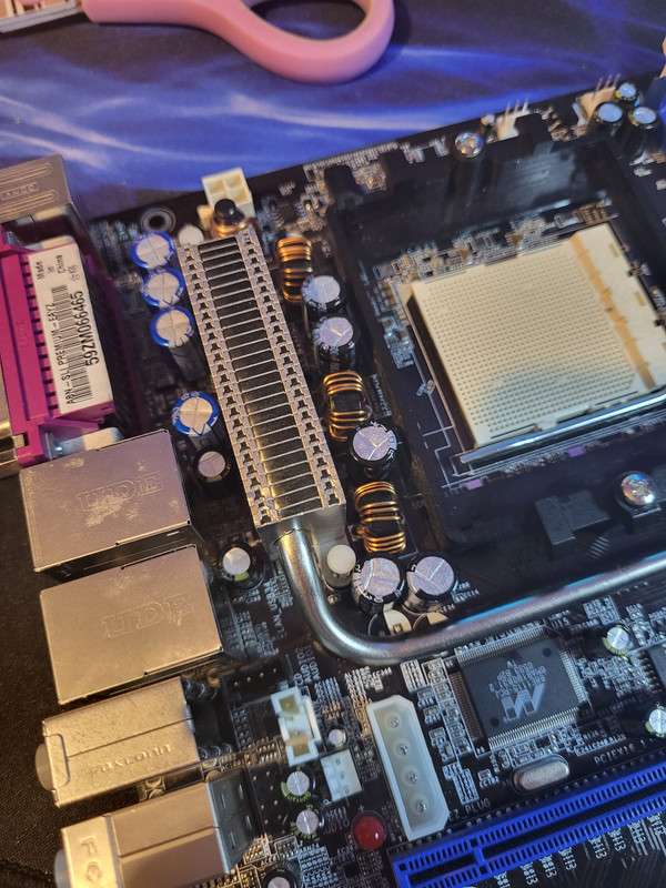

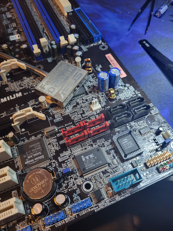

New Charger for the Asus got here today. Not overly cheap sadly but worth it to see if its some sort of smart supply. Means I can now massacre the old broken supply and have a look at it. Can also test the dc jack on the rog now, what is it with things and DC/AC jack issues.
