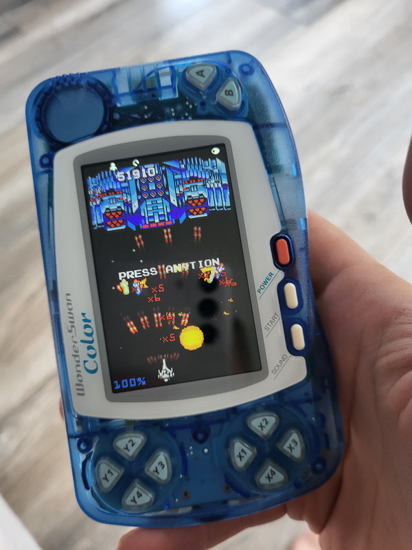

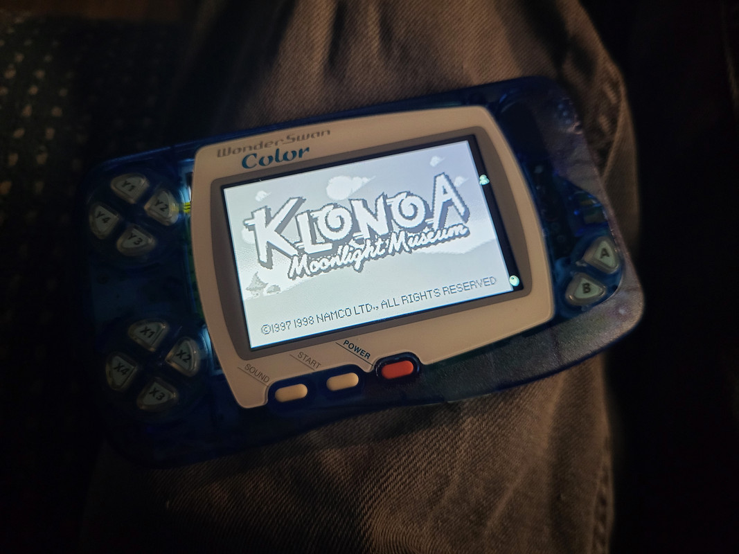

Bit of an image dump of some things I've been working on...

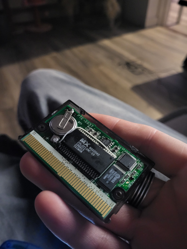

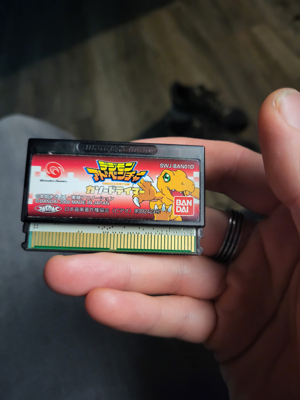

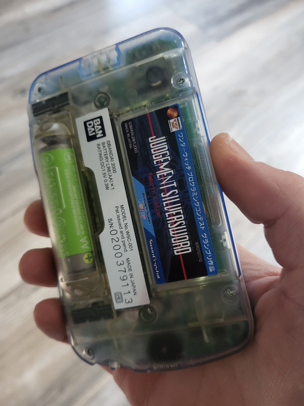

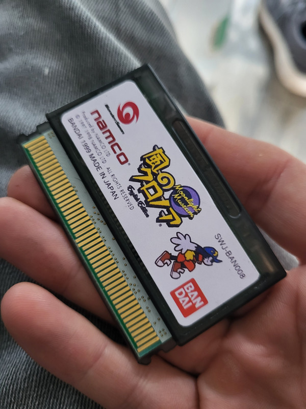

This game was useless to me so I rom swapped it, and honestly this new game is a great little game!!

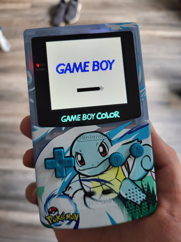

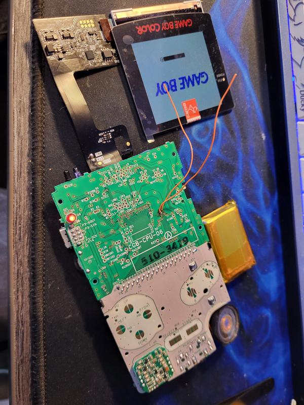

Another GBC build.. this time its a squirtle!!

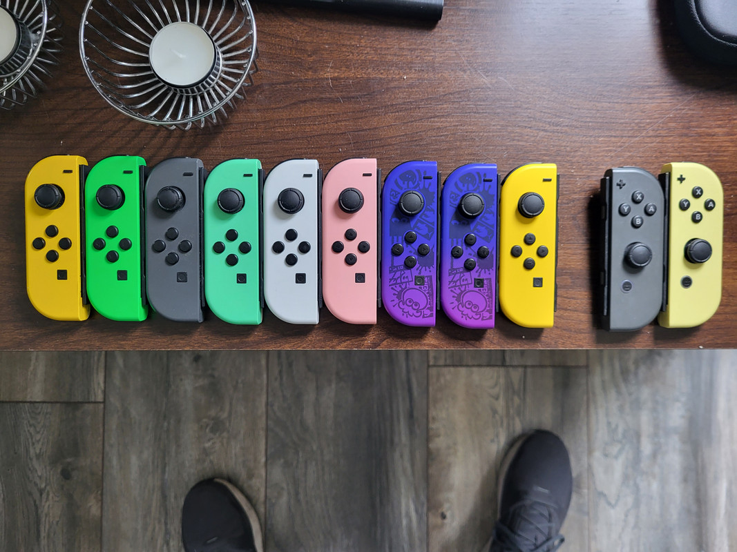

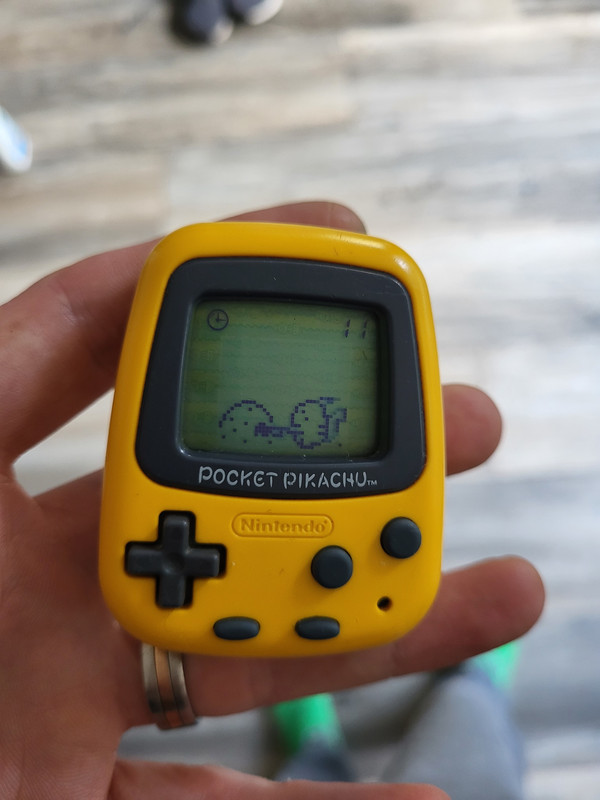

And I decided to fix some more of these bad boys... love these little things!!

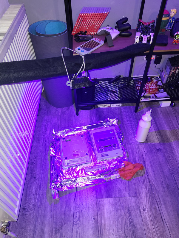

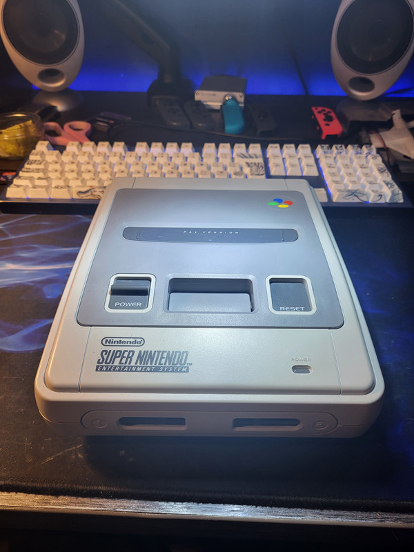

First up I finished up a retrobrite and restore on a snes:

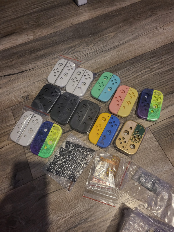

And all these goodies turned up:

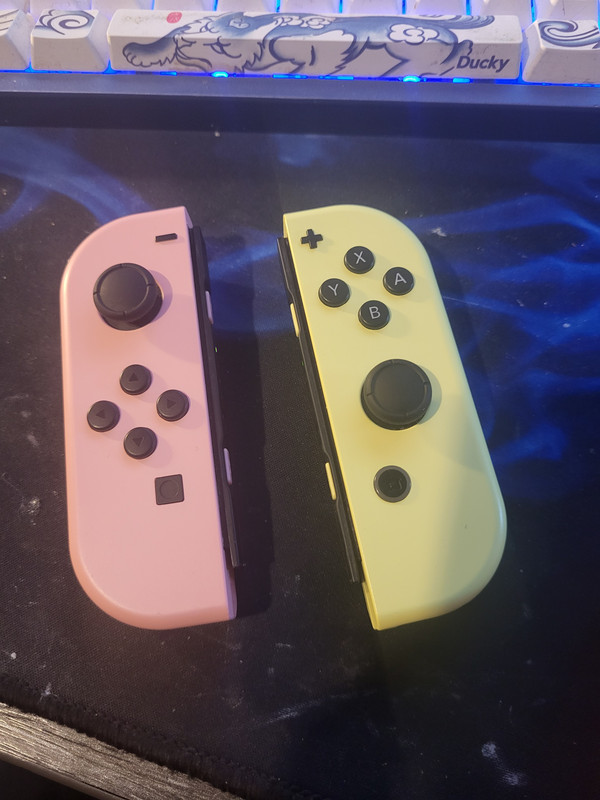

So I fixed and reshelled/reprogrammed a set of joycons!

Good work on the SNES! Was that all done by wiping a product on it and then using UV?

Yea it was super yellow so i just coated it in 40% peroxide gel with a paint brush and put it under a 15w UV flood light. I re-apply a bit every 4 hours or so, so it doesn't dry out and after about 12 hours the yellow is generally gone :)

Sounds simple enough. Must give that a go on some of my laser printer panels. Checked earlier and was somewhat amazed when I realised I bought it at the start of 2008 - quite the purchase, almost 16yrs of service for about £140 :D
I fixed a few more joycons last night, slowly getting through my box of joycon spares and building as many as I can. Waiting for some parts for the right joycons and some more right ones I've ordered to come in but right now I have an abundance of left ones all fixed up.

I thought you couldn't get the stuff for retrobright in the uk anymore? I looked into it as my snes is yellow and just saw people complaining you can't get the hydrogen peroxide in a high enough concentration for it to work properly :(. I never looked into it any further after that.
