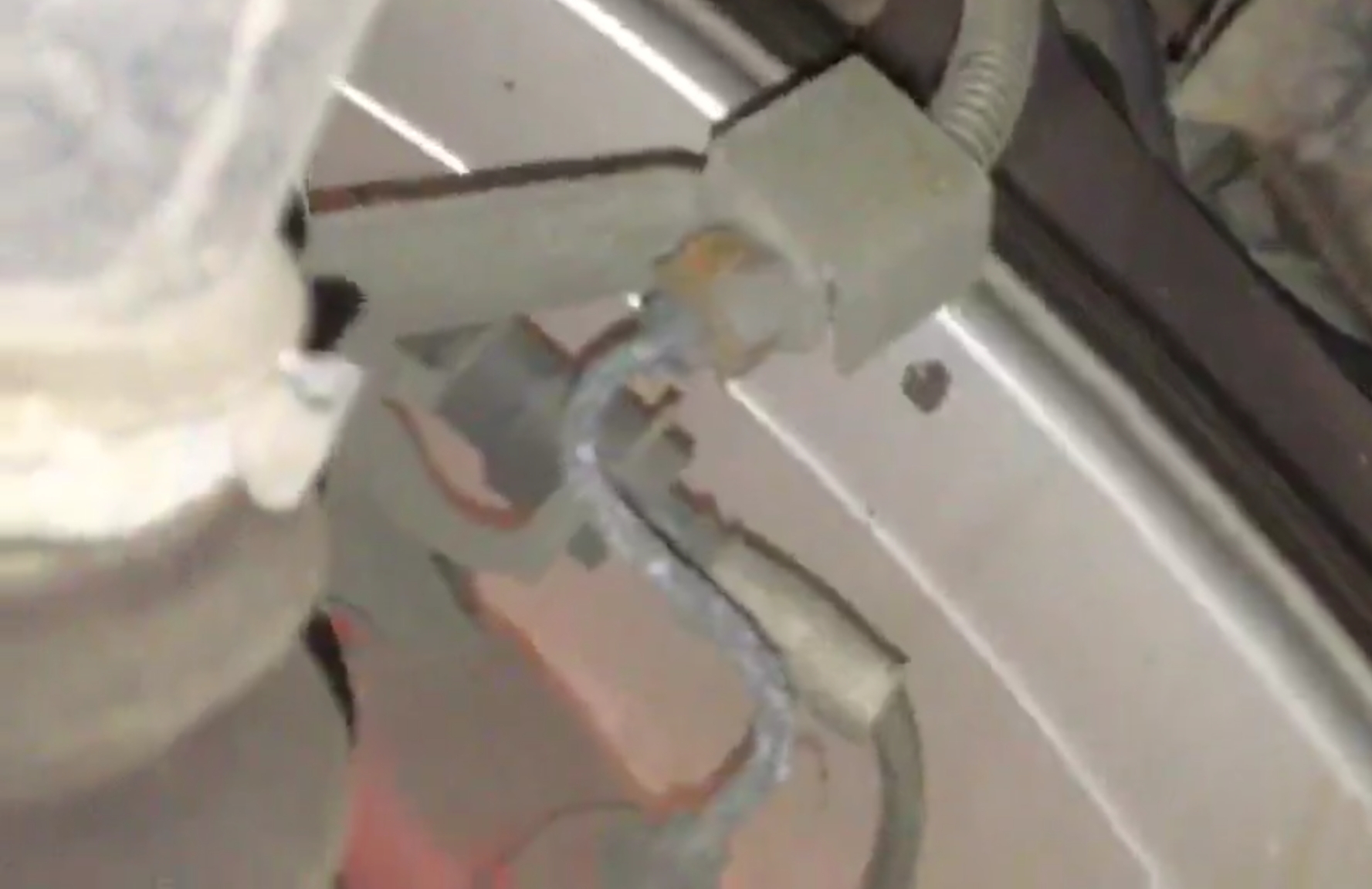

I did. Which is why it's interesting! I'll get some photos of the pipes up later and let you see for yourself how little corrosion there is.

Quite hard to tell from the not particularly close-up blurry picture, but it doesn’t look “excessively” corroded unless of course up close there is some potential seepage or what looks to be deep pitting?
