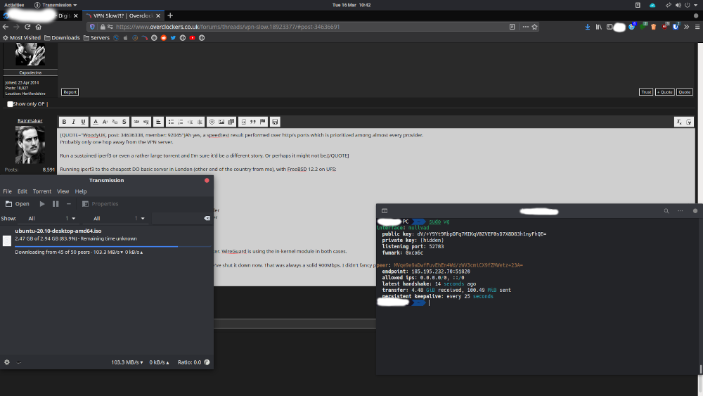

Run a sustained iperf3 or even a rather large torrent and I'm sure it'd be a different story. Or perhaps it might not be.
The traffic coming back to me from the server isn't coming over 443/https, it's coming over 51820/udp (WireGuard), and it's still basically wirespeed.
Running iperf3 to the cheapest DO basic server in London (other end of the country from me), with FreeBSD 12.2 on UFS:
Code:
Test Complete. Summary Results:
[SUM]   0.00-10.02  sec  1.03 GBytes   881 Mbits/sec  465             sender
[SUM]   0.00-10.00  sec  1.02 GBytes   877 Mbits/sec                  receiver
snd_tcp_congestion newreno
rcv_tcp_congestion cubic
The OS at my end was Fedora 33 x64 through an OpenBSD x86 router. WireGuard is using the in-kernel module in both cases.
Ubuntu torrent at 103MB/sec (864 Mbps):
Sorry for the potato quality, I resized it to 1000px and the image host seems to have squashed it further. It's legible enough, and shows wg being connected to Mullvad as the torrent is running.
And another speedtest from another day:
I stand by what I said. I see full gigabit (across all downloads and transfer types/protocols) 24/7. If you don't, either your setup isn't right, your provider is rubbish, or there's something wrong. ;)
