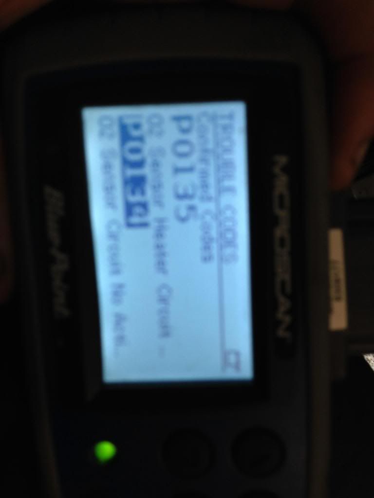

i have a beetle 2000 2.0 8v that is getting the following errors. i have replaced the o2 sensor before cat with one of a scrap car put still getting get same error can anyone help ? Its just gone for it MOT and failed on the below
P0134 - 02 Sensor Circuit No Activity Detected (Bank I Sensor 1
P0135 Heated oxygen sensor - bank 1 sensor 1 (H02S11) sensor heater circuit
I have tried and checked fuses changed the Lamba for a 2nd hand one of a scrap car to try as there £70 for euro car parts but there not returnable if opened and a waste of £70 if it don't solve it. Just wondered if anyone on here has had this problem
sorry for crap photo quality just what garage sent me
.. any ideas
