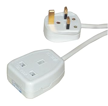

Get one of these
and one of these
and extend wire.
£1.98
