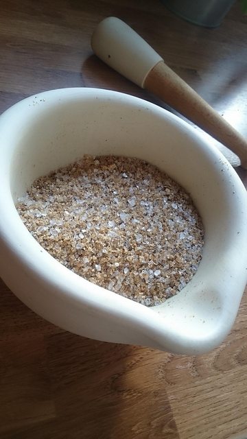

The cure ingredients:
As per the recipe, but with added coriander seed which I will grind down. Most other recipes have coriander seed in the cure, and I like the sound of it.

So I made the cure as per the recipe, reducing the quantities to match the weight of my bit of pork. I simply used a percentage calculator to tell me how much smaller my bit was, then multiplied all the measurements by that percentage (37%). Coriander seed wasn't in the recipe so I just used the same amount as garlic, about 10g. I ended up using sea salt rather than the table salt in the previous picture, it has a better taste than standard salt so thought it just made sense. The cure smells amazing!
