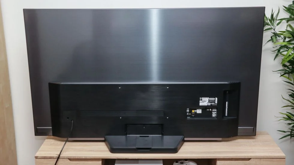

I think the LG OLED wall mounts are set very low on the back of the TV (Last year LG OLED models were)
Back of LG C9
