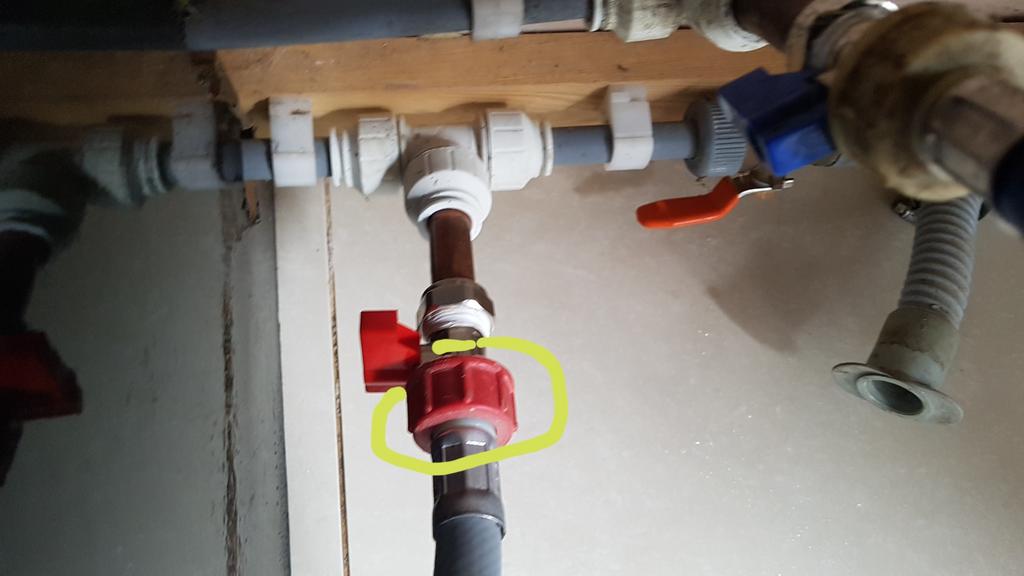

Woohoo, finally got it off! :D I removed the whole hose, seemed easier undoing the red wheel on the machine end. I think I need 3/4" cap to go on that valve.
Guess I'll need to undo the wheel for the cold water hose now ready for a new hose to go on that presumably will come with the new machine , right?
Yeah, see my post #50. That's the hot water valve standing up showing the thread that needs capping. I'm gonna take that with me to the shop.
Well, I've been advised to cap I suppose because the valve switch could get accidentally knocked to the on position. Unlikely though.

Actually, although the cap seems to fit perfectly, I'm able to move the valve lever a a few millimetres and that lets water come out, albeit not shooting out like a jetstream as it does without the cap. So it works but not foolproof. I don't know if this is normal or not.

Did you buy the rubber washer to go with it as it won't seal without it?
Toolstation sell the brass caps without the washer for some odd reason, whereas Screwfix and others come with the correct washer.
Thank you Simon, rubber washer didn't occur to me. You nailed it! I went back to Toolstation and they still couldn't offer me a rubber washer for the brass cap, he said they don't come with one. Very odd, so I got a refund, went to Screwfix and got one that does come with a rubber insert. Fits much more snug and absolutely no leaks now even if the valve switch were to get accidentally nudged to the slightly on position. :)
The blanking caps that come without a washer can be used with a standard washing machine hose washer. Toolstation and Screwfix both sell those washers for about a £1 for 10.
Yeah Simon, I just noticed the black rubber washer/gasket inserted in the end of my cold water valve, so I'm thinking the hot water washer might actually be stuck in the end of the red plastic nut on the hot water hose I'd removed.
Was it this one, for £1.89? If so, I might get one for my hot outlet, just for peace of mind. I am weary of the one review which states it doesn't come with the rubber washer shown in the picture.
It's not that one darael, and I can't seem to find it on their website. But mine was slightly less at £1.35, it's 3/4" and it comes with a black disc rubber insert which is visible in my photo.
I flooded part of my kitchen tonight. After putting the cap on I decided to unscrew it again to check something, but I inadvertently was unscrewing the whole valve from the main water pipe instead of the cap and warm water gushed out everywhere like in a Carry On movie. I was like "oh no..no no!!", panicked a bit but eventually turned the main hot water inlet lever to off and spent the next hour mopping up. :p All ok now and ready for installation.

Yes, I found the item number on the receipt, it's 39553. Actually, with that number I found it on their site. https://www.screwfix.com/p/bsp-blank-nut-x/39553?_requestid=879981
