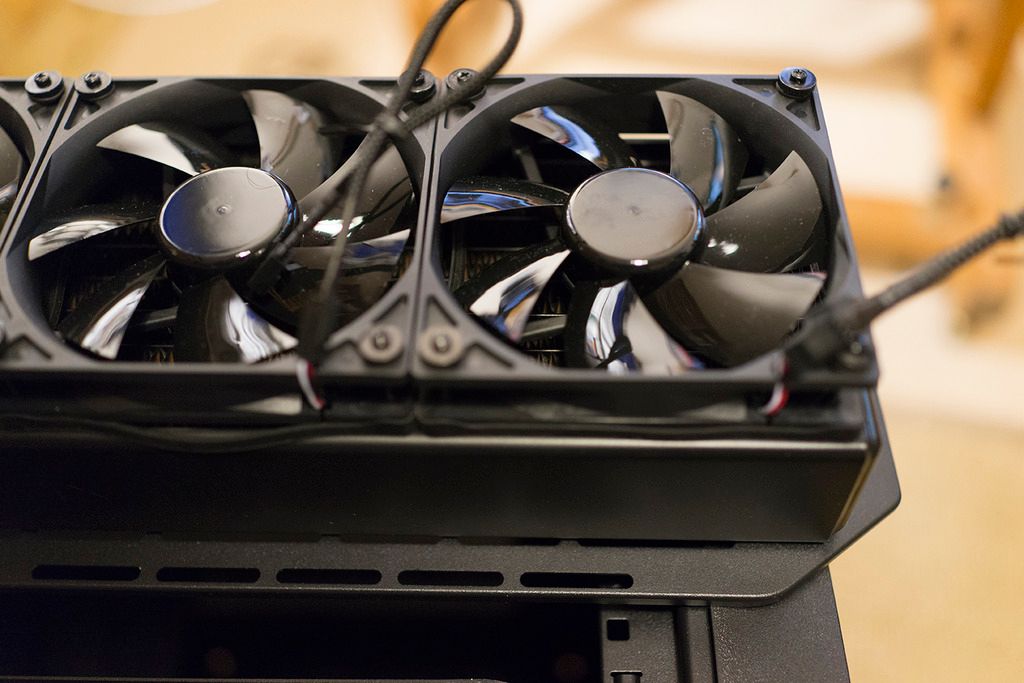

This is my 1st Water cooled rig so I will keep this thread going as I build it.
These two 480 rads are going in the top. The BlackSilent Pro Fans have no flow markings.
Is these the correct way? Or should they go the other way.
I assume this way the air gets pushed out of the computer, but maybe it is better for the air to get drawn into the computer over the rads?
Advice please.
Unless that raidator is upside down (maybe it is - I see it is on a bracket?) I believe that configuration will lead to cool air from outside being pulled into the top of the radiator and thus warmth from the radiator will be directed into the case. I think you want them to draw the warmed air out of the radiator and the case and so should have them the other way around.
If it IS upside down then it will push air from the case into the radiator and out the top ;)

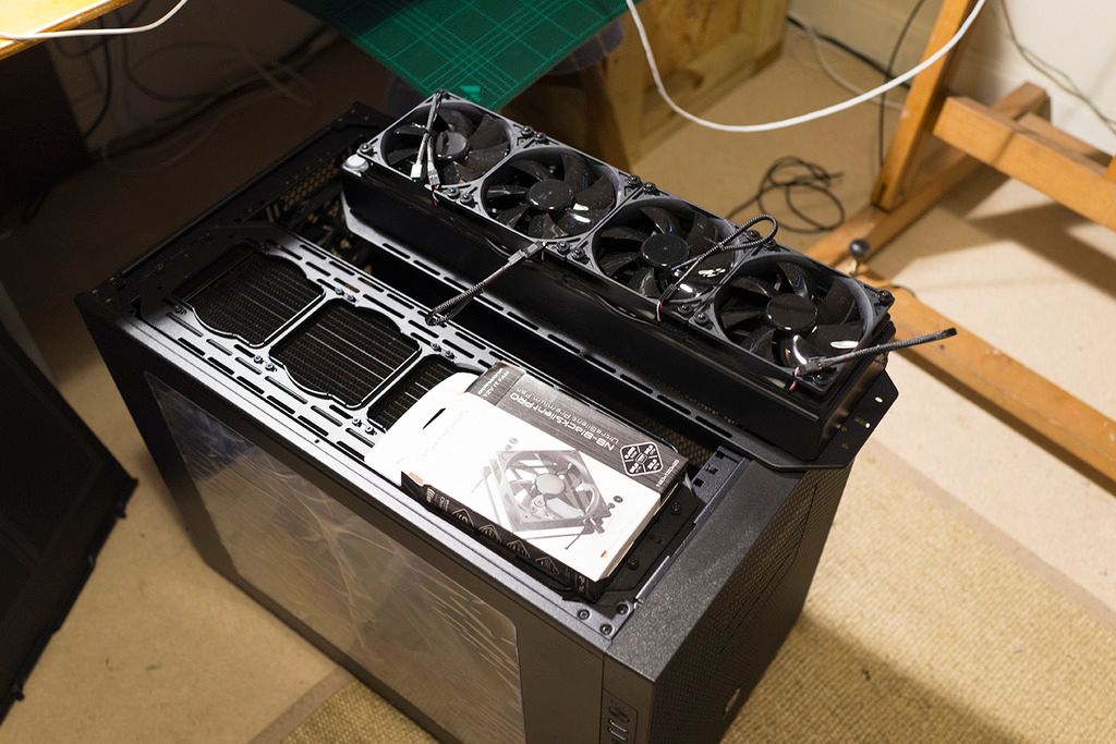

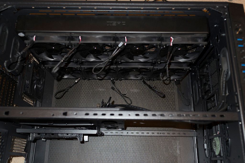

Sorry I should have been clearer as to it's position/direction. Here a pic of the rads fitted looking upwards.
That's fine, those will push the air into the rad and out of the case. Air is pushed towards the ...bearing holder centre bit? (I know it has a proper name but I need to go to bed)... of the fan.

With 2 480 radiators blowing out of the case you will need a good amount of air going into the case. I would say atleast 4 120 intake fans.
