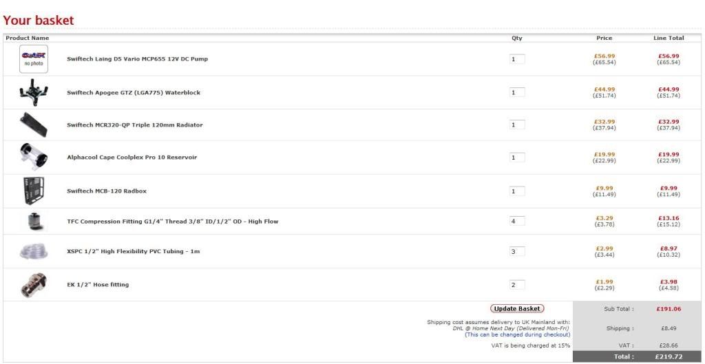

Same case as yours mate. Here are some pics you might find interesting considering our set ups are VERY similar :D
:D
Swiftech GTZ
Thermochill PA120.3
Laing DDC 18w
XSPC Reservoir Top
10ft 7/16 tubing
3 x yate loon 120mm
above would total about £190ish
*edit* if you want to WC the 4870x2 then add another £80 or so onto the amount. I would recommend it, the air cooler is a bit :eek:
thermochill rads are better than the swiftech offering as they use a dual row dual pass form factor, opposed to the swiftech which is single row dual pass.
check this http://www.xtremesystems.org/forums/showthread.php?t=77260
"As you can see from the above figures, the PA120.2 with shroud manages to effectively match the Swiftech MCR320, with less noise due to fewer fans in play..."
