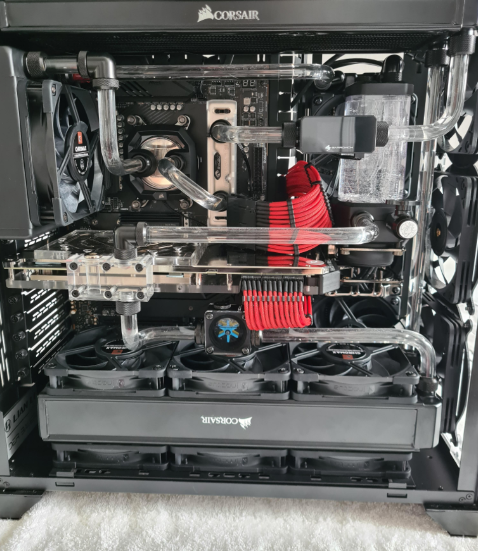

Most recent look at where my build has gotten to, all my rads are intake. I'm spoiled with 4 radiators, so that does allow quieter operation lol.
