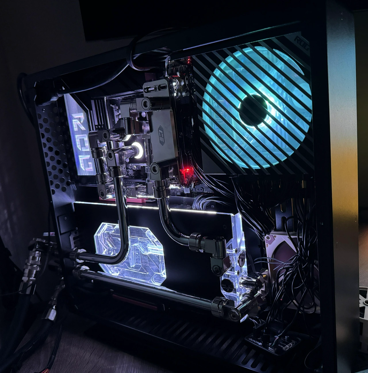

Less than 15L on the desk, 4m of tubing to put my external rad behind the bed.
9950X3D & 5090.
9950X3D & 5090.
This is the way! So happy to see that you haven't put any radiators inside the case. See so many builds with external radiators that are ruined by heating up the case with a rad. Lovely work!
Would love to see some basic temp results!

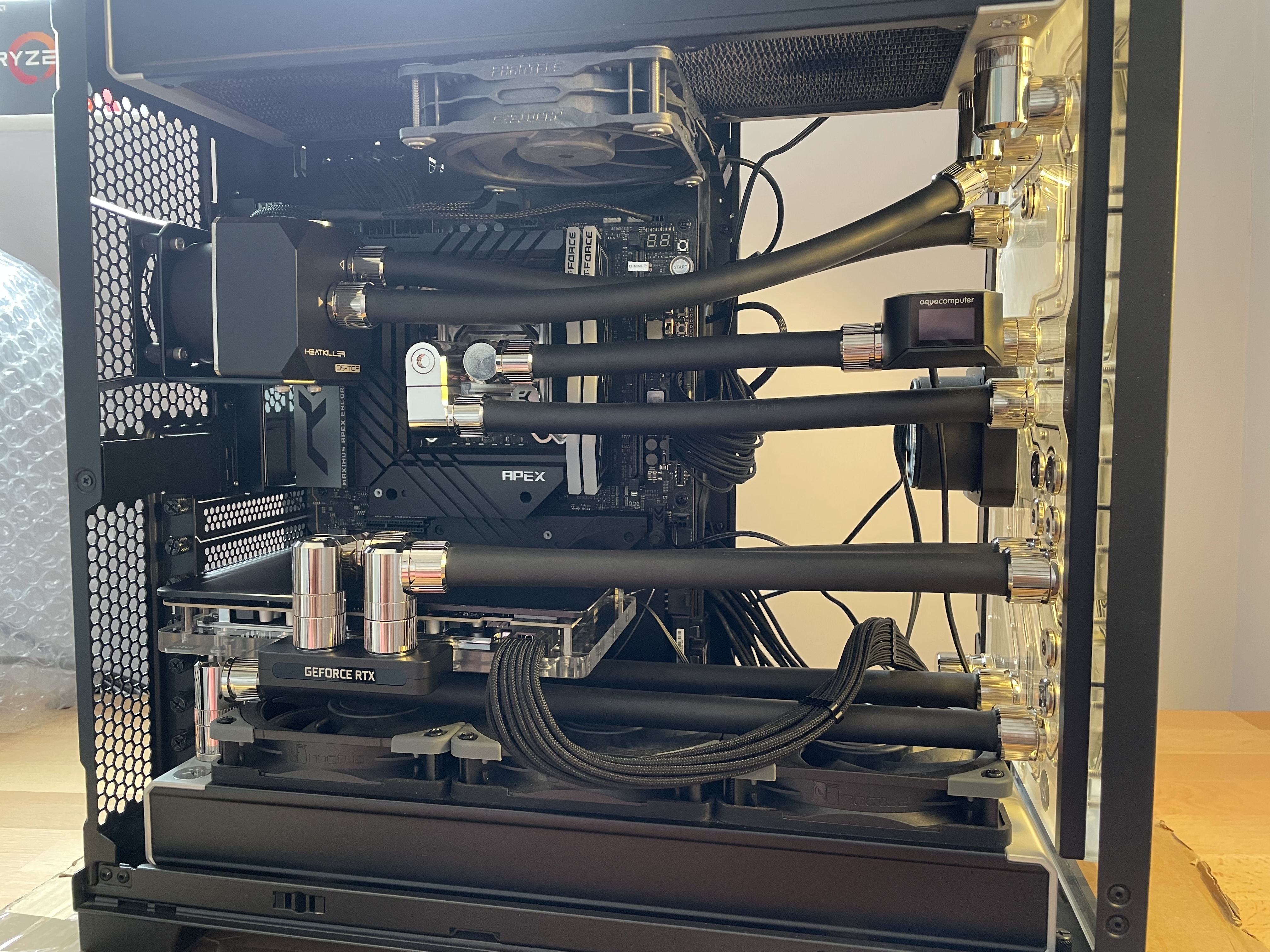

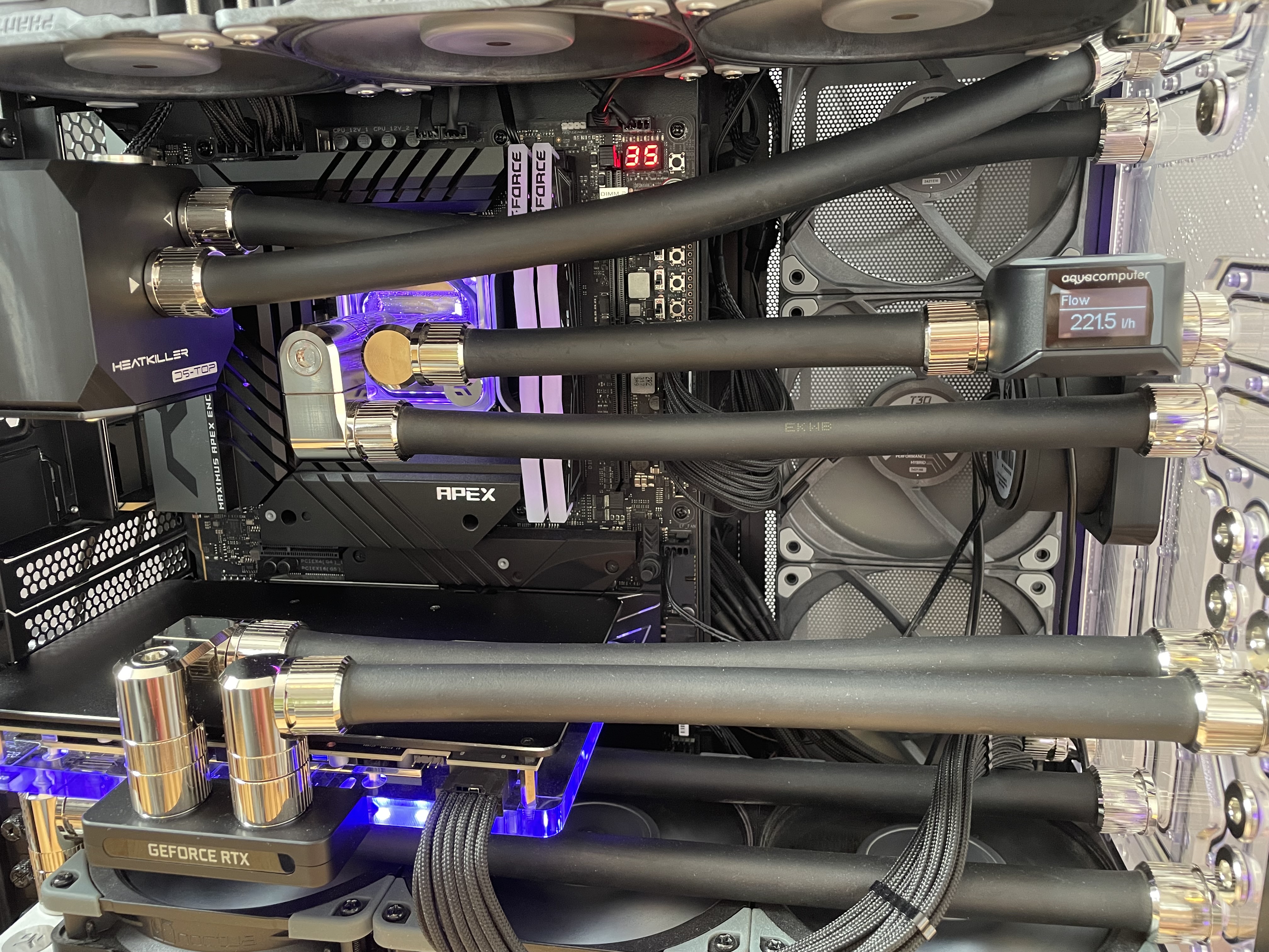

I have gone through on a few different iterations of the 'classic' EK/Lian Li Dynamic Evo build.
The default setup with the Reflection 2 Distro Plate has one pump and with 2 radiators and CPU,GPU etc. in the loop the maximum flow I have seen is about 170l/h at 100% pump speed (which is louder than my fans, possibly due to connection area on the distro.)
Without the GPU in the loop it hits just over 200 and very close to 1 gallon per minute.
I have been thinking about trying to add another pump to the loop and have added it to the 'side radiator' inlet and outlet ports.
I had to remove the top radiator with the push in fittings to change one fitting. This was an absolute nightmare and definitely not as easy as advertised.
This probably could have been done in an easier more aesthetically pleasing way, but I am happy with the outcome.
Have not had the chance to turn it back on yet as the top rad issue led to a small leak, so I am waiting a little while just in case.
I know pump speed is not everything, but I would love to get higher flow and maybe turn pumps down too, even if there are now two to add to the noise.
Its an Alphacool 5090 and 14900KS with the Asus Apex Z790. x2 D5 pumps (EK and Watercool Heatkiller.)
Hope you guys think it's interesting!

Looks lovely and as longs you're happy with the outcome that's the main point . My new build with one DC5 pump managed to push 200, that pump is from Watercool. What's the temps like with the 14900KS and 5090?
That’s a good result at 200. Is that at 100%? All depends on the loop and restrictions I guess. I am just trying to fight that. Temps on 14900KS are not too bad now I undervolted. Goes to about 1.35v max but still mid 80s highest. I locked the cores to 5.9GHz. Not using a contact frame or direct die or anything. The 5090 is a dream on the other hand. That is also undervolted to 0.900v @2827MHz and doesn’t go over 50c. Pleased with the Alphacool block. I don’t let it run 600w though.
Yup, that's running at 100%. Indeed, I try not to have too many 90 degree turns in the loop. I would suspect running a pump at 100% would shorten the life pretty quickly.
That's a really nice temperature for the 5090, I'm still waiting for my GPU waterblock (ordered back in March, it's for a 5090 second build). Hopefully will get delivered next week.
My current temps for the 3080 Ti is 55 degrees and that's running at around 85% when gaming with medium to high settings (normal volts). For the CPU I get around 60 degrees when running at 60 to 70 %.

That's beautiful mate! Fair play!
Is that actually two separate loops, or one loop with two pumps? - had a look at the distro and thought it was one.
Looks awesome either way and temps seem decent!
It’s one loop with two pumps. Regular D5 on the Distro plate and new D5 pump added to the ‘side radiator’ inlet and outlets of the distro, as it is designed for up to three rads and I have two. I took radiator as more of a guide and presumed it would work with any block, which it does as I just did the leak test and all good. Flowing in the right direction at least! Not powered on yet though to test. Soon. Thanks!
