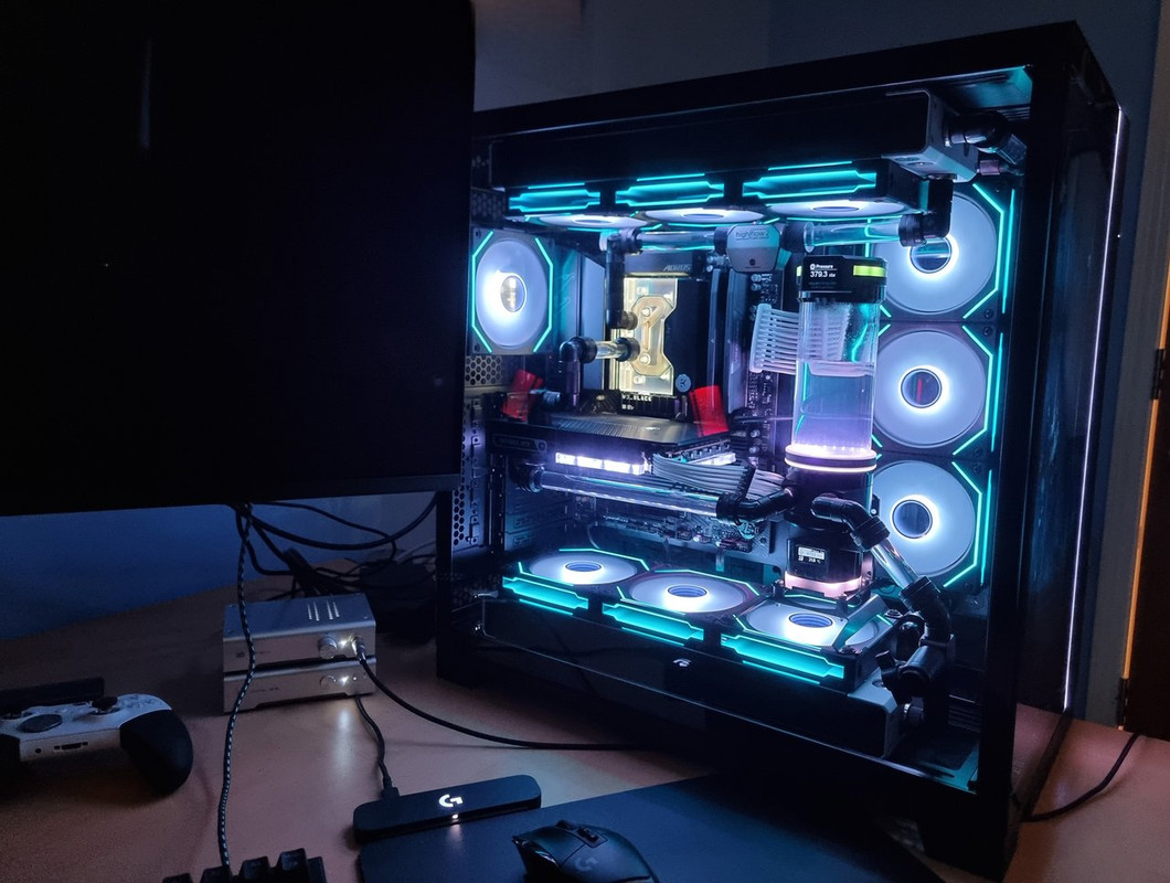

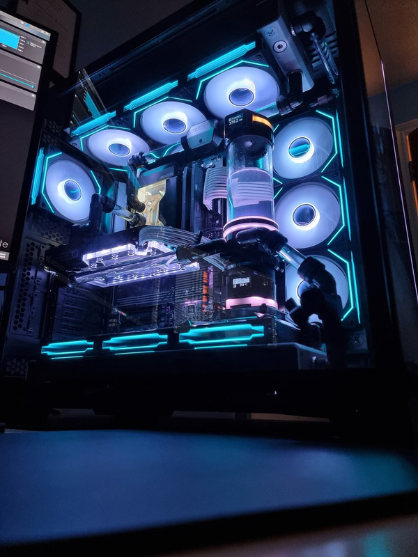

Afer a long service (10+ years) from my Corsair 900D I moved into a new O11D Evo XL home!
Was a long process with a few challenges to overcome that I hadnt visualised when ordering fittings.

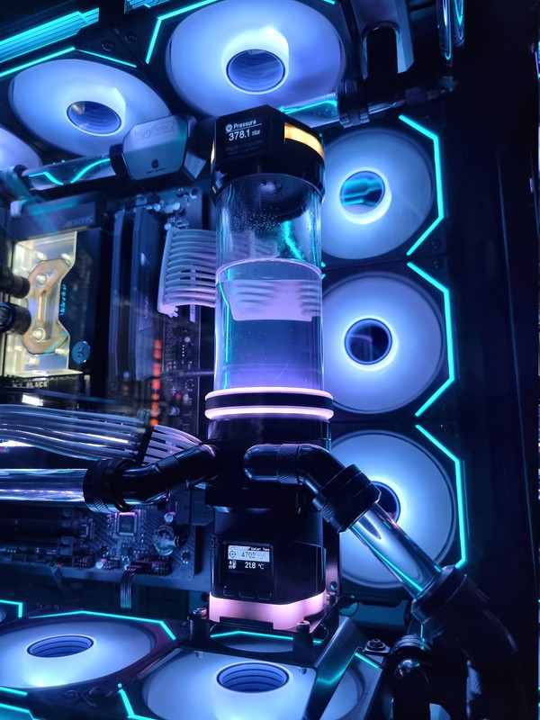

Had to buy a shorter Aquacomputer reservoir but fortunately you can buy just the tube as a replacement part. Replaced the 200mm one with a 150mm.
Migrated away from PETG to PMMA. Whilst PETG is super easy to work with it doesn't quite have the clarity and appearance PMMA gives...I do miss being able to use ratchet pipe cutters instead of sawing though!
The O11 was a joy to work with and has been very well thought out. The only thing I would have liked to have seen is openings in the top panels to access radiator ports to make bleeding easier. I did consider going to 420 rads (which the Evo XL supports) but I felt it was going to be far too tight, a cross flow 420 would likely not fit. As much as I would like to remove the support column where the glass meets, the upper radiator is far too heavy and causes some notable sag in the corner which Id rather avoid long term.
I've ordered some extra fittings and bits and bobs to rejig the fill/drain port location and I might move the flow meter also.
Have some more braided cables on order to make a better/easier job of the cable management in the rear chamber. (Hence no cable management pictures yet :o)

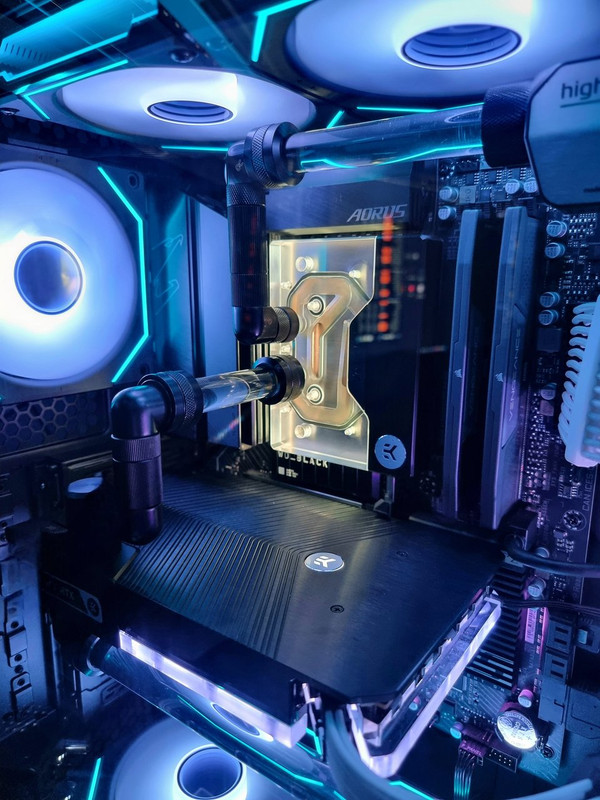

EK Vector 5090FE Block
EK Velocity 2 CPU Block

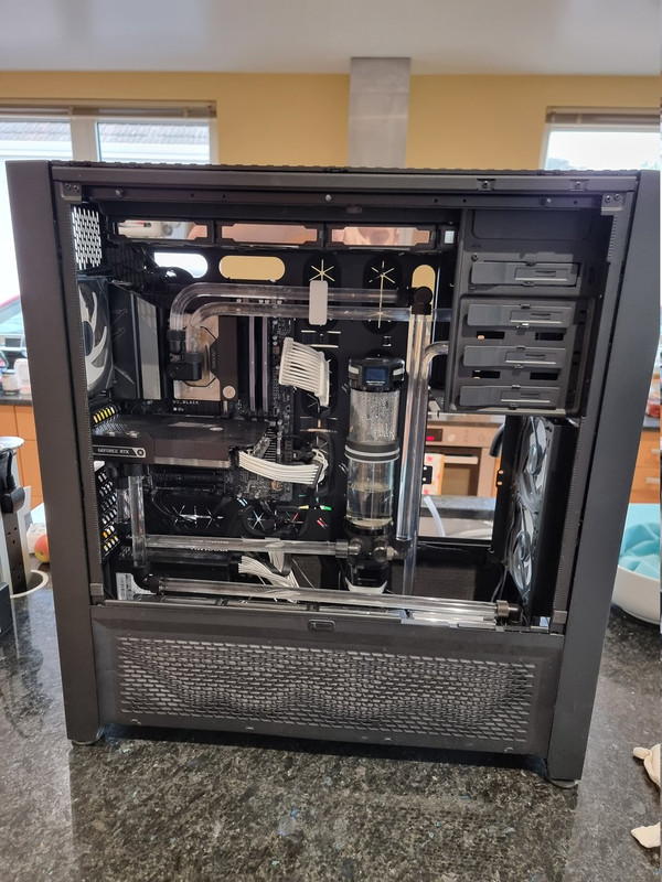

The outgoing 900D build, redundant 5.25" bays and all!

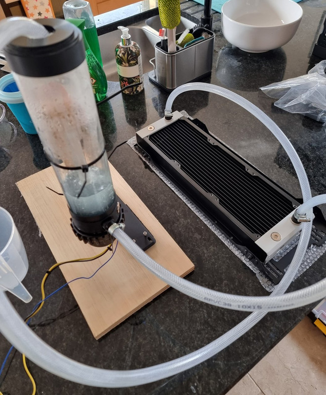

Old water cooling parts to flush new rads. The EK surface rads were actually rather clean. 2 of the 3 had almost no residue, 1 had a little more.

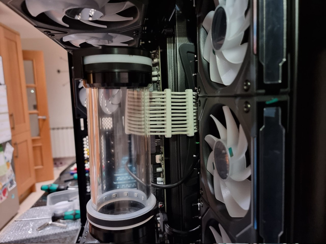

DIY 3D printed cable combs coming in handy.

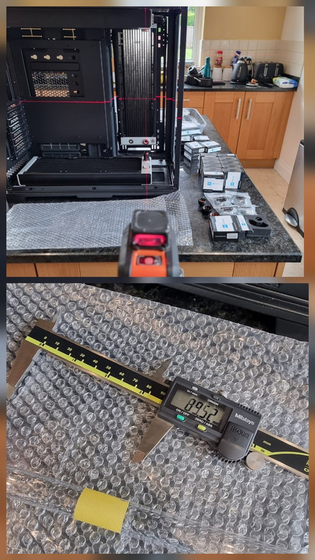

Spending the time to be accurate, putting the laser level and calipers to good use :D

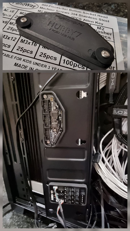

Hole spacing on the Aquacomputer Octo and Hubby were just right to use the SSD mounting kit in the O11
