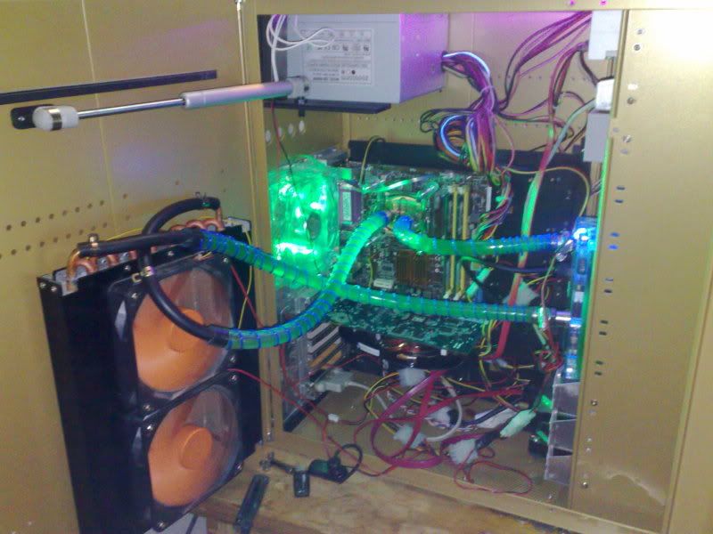

bit of a mess the wiring for now, but it will all be getting the attention soon when i get a new powerpack and start customising it with great detail xD
