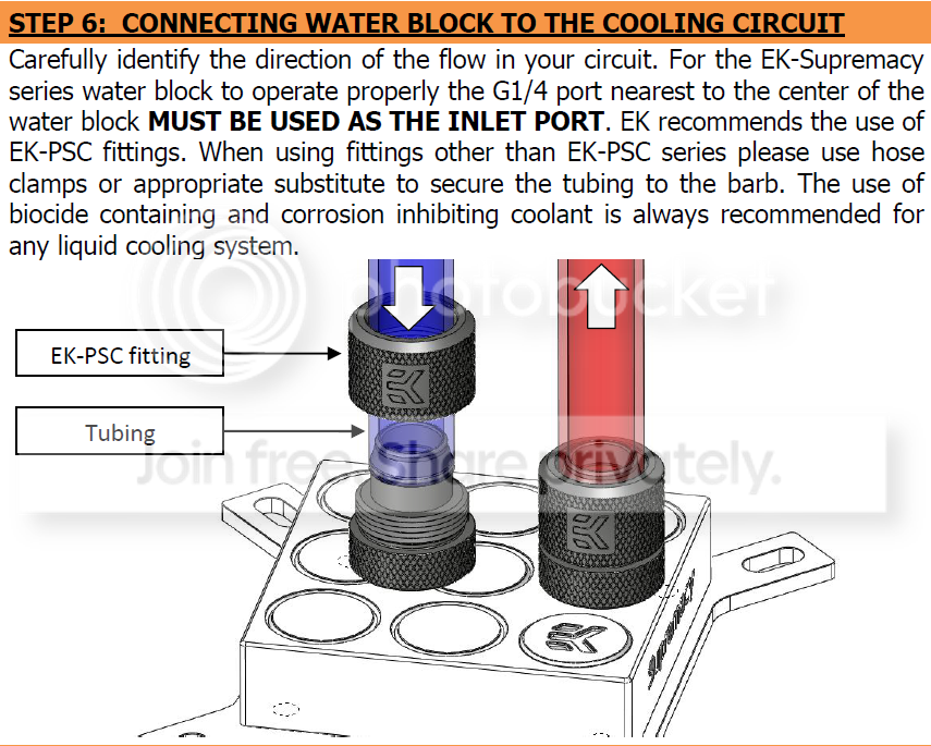

Edit: just realised you have an EK block. Do you have the flow going the correct way through that block? it must be input into the centre hole of the block and outlet to the outer hole of the block.
Well ****! Don't suppose there is a way to switch these without draining the entire loop?

Just to be sure for you here's the fitting instructions. Not sure if all blocks from ek are the same so please do check on their site
http://www.ekwb.com/shop/blocks/cpu-blocks.html
http://www.ekwb.com/shop/EK-IM/EK-IM-3830046990570.pdf
I fitted mine wrong way round when i built mine first time around.
Change the flow of your loop at the pump end, that's what i did. Otherwise, no, you'll have to partially drain and switch them over.
