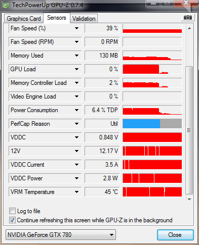

Running Heaven looped with gpu-z monitoring at the same time keeps showing dips in voltage, wattage and ampage plus is giving me a VREL performance restriction which says it's caused by voltage reliability. Here's a screenie showing the dips:-
Clicking on the minimums shows the following:-
VDDC -125.000v
12v -0.50v
VDDC current -1824.00 A
VDDC power -92.5w
I can hear the card stuttering when these dips occur as the PSU whines. Despite what my multimeter testing shows i think i am going to need a new psu to try to cure this problem. It was fine with my old GTX670 but this new card sucks more power so perhaps at 5 years old it's now past it's best.
