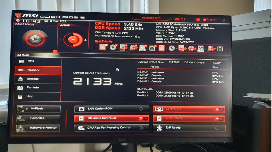

some screenshots:

ok, so i made sure the XMP profile was disabled, then tried to select a higher ram speed. No joy.
I went into bios, nb/soc was set to auto, at about 0.8 something volts. DDR voltage was 1.2ish volts.
1) Changed nb/soc to 1.1, saved, boots into windows. confirmed change with HWinfo
2) Changed DDR voltage to 1.35v, saved, boots into windows, confirmed change with HWinfo.
Back into Bios, i could see soc and DDR voltage is where i left it. Upped DDR speed to 2666 or something low, highest timing numbers. Save, it reboots a few times, into windows eventually. RAM is still slow, and now the SOC and DDR volts are back at 0.8 something/1.2V for the DDR.

in both boards, two sticks work at default speeds. in the ATX board, 4 sticks work at default speeds. in both boards, the ram only works faster with one stick.
Thanks
cleaned all the pins and the socket with IPA, still no change. nothing but 2133Mhz with 2 sticks.
