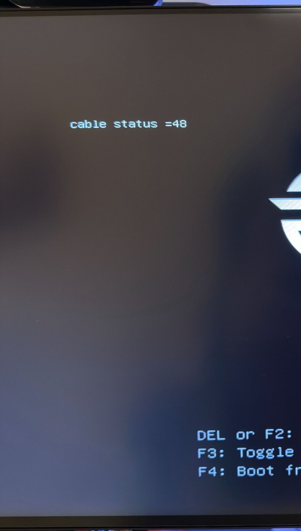

On boot up my PC is showing this message. Not even sure if its an error :
It doesnt happen after a reboot only on cold start and doesnt seem to affect the system running.
Even tried the display port cables for my two monitors in different arrangements on the 5080 to see if that helped and it didnt.

If that's the BIOS you're looking at, wouldn't it be more likely to relate to the LAN cable than display port?
Hey there, its just as soon as the PC starts up and is waiting a sec for F2 / DEL - so completely at a loss on it and never seen it before on other systems :S
I saw something that says some bios do a POST of the lan cable status.
Check your bios and see if there is a cable status check option, and if so see if disabling it stops the message.
If that doesn't change it, you can also disable the internal LAN controller to see if the message stops appearing. That will at least tell you whether the LAN controller is generating the message.

Hey everyone ... thank you!
It is indeed LAN related even though google shows NOTHING when I check as does the motherboard manual or anything else.
Disabling onboard LAN makes the message disappear!
Thanks :)
