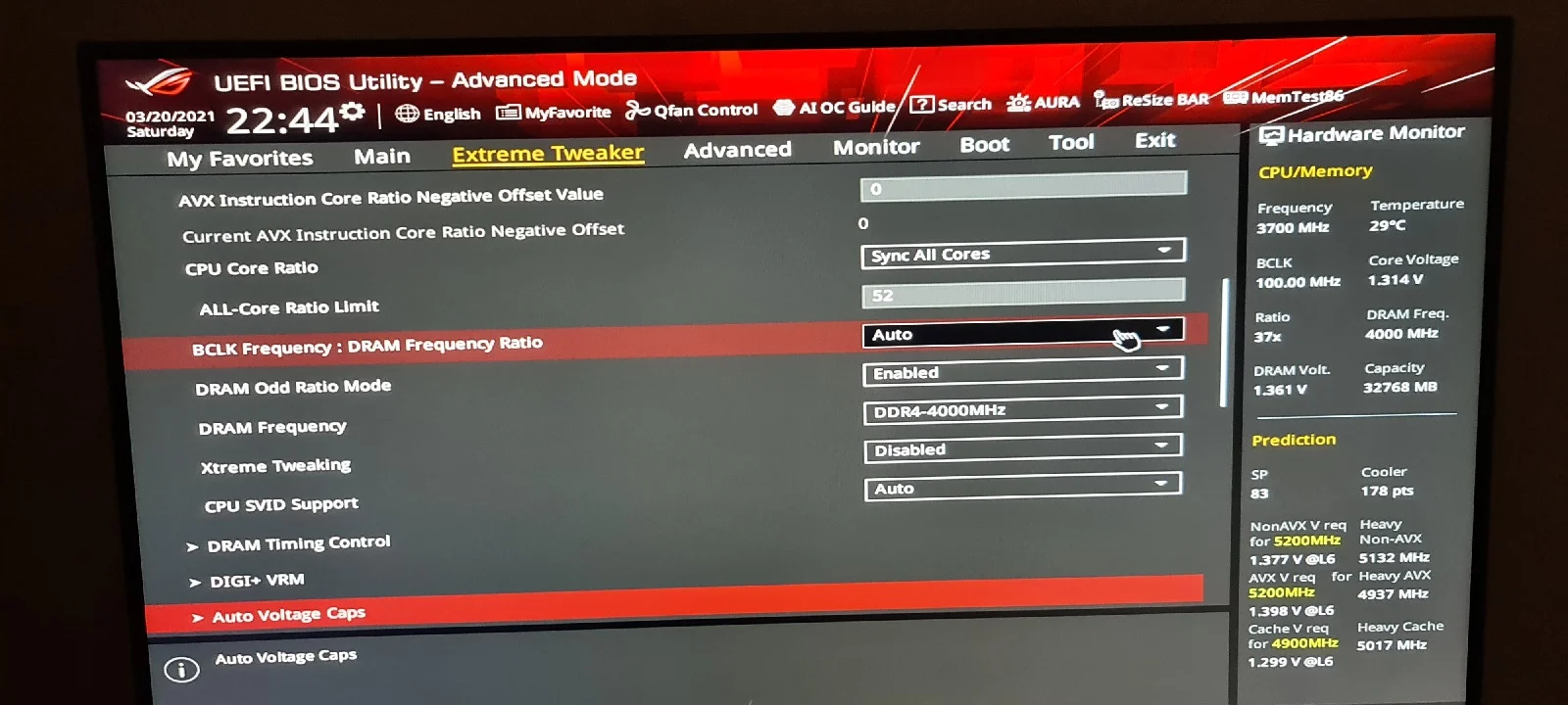

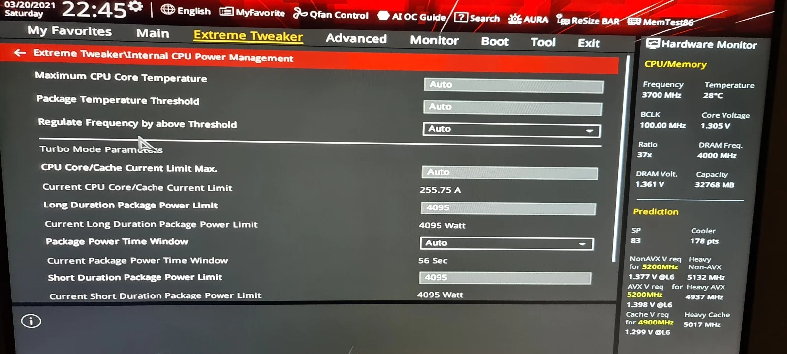

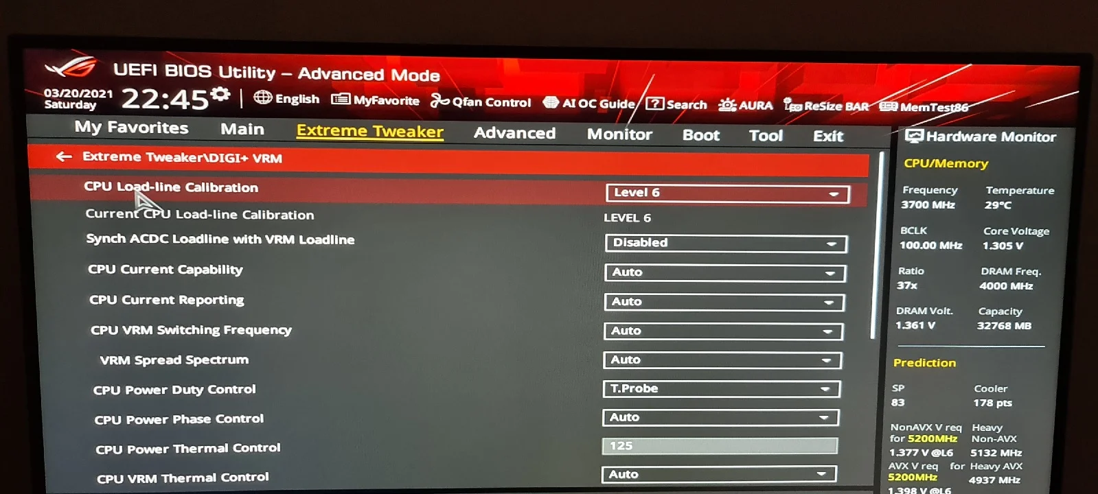

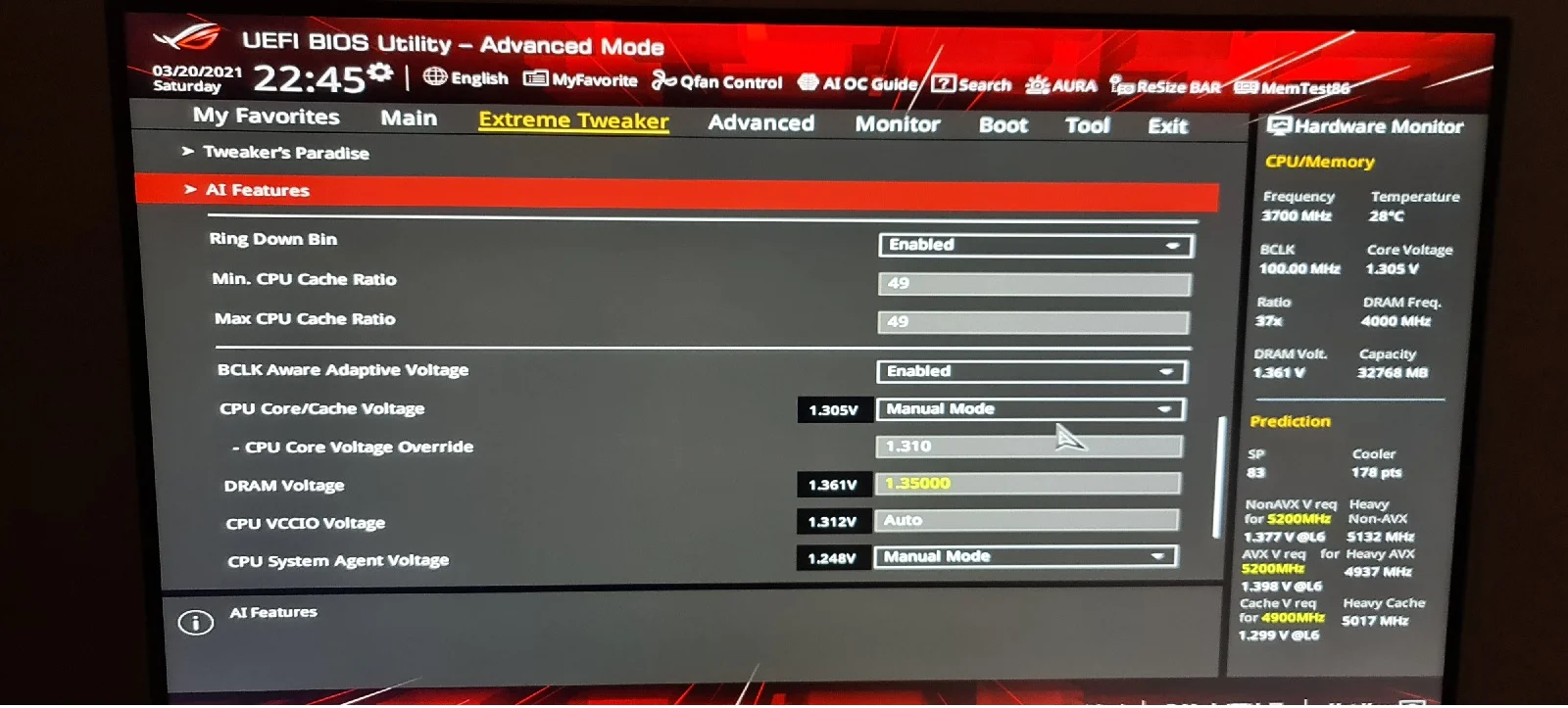

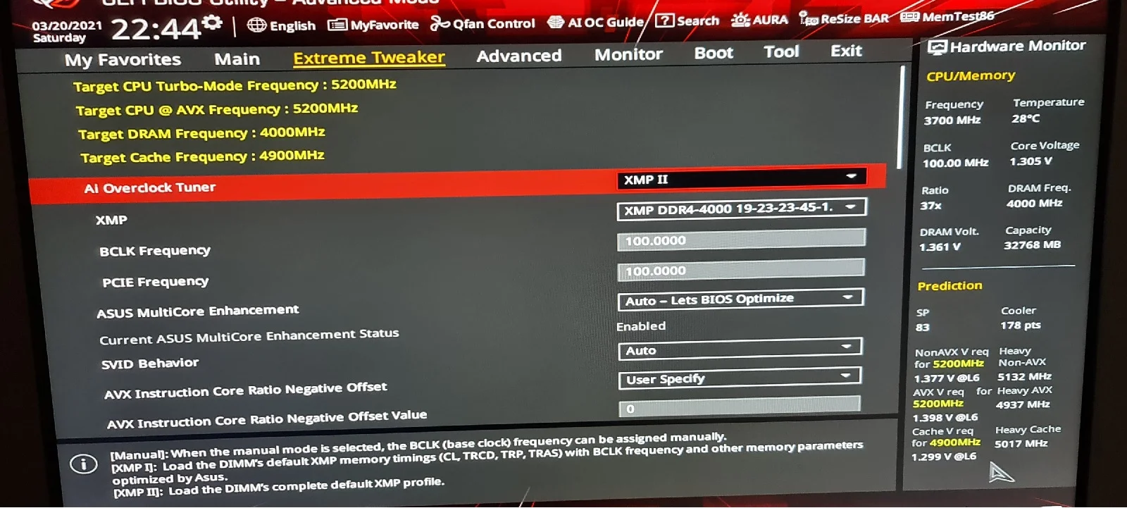

Hi
I seemed to have run into a weird problem when trying to overclock my 10900k on my Asus Z590 Motherboard. I can set it to run 5.2Ghz and I can see in HWInfo that it does reach that speed, but after a few mins it will down clock itself to 5.1Ghz. I am not sure why this is happening. If I try and raise the overclock to 5.3Ghz the same things happens. It will start of at 5.3Ghz but then will not go any higher than 5.1Ghz after 5 mins or so. My temps all seem fine to me. I have attached screenshots of every setting I have messed with in the Bios. Have I made a mistake somewhere?

Under 'Asus Multicore Enhancement' you need to select remove all limits.
