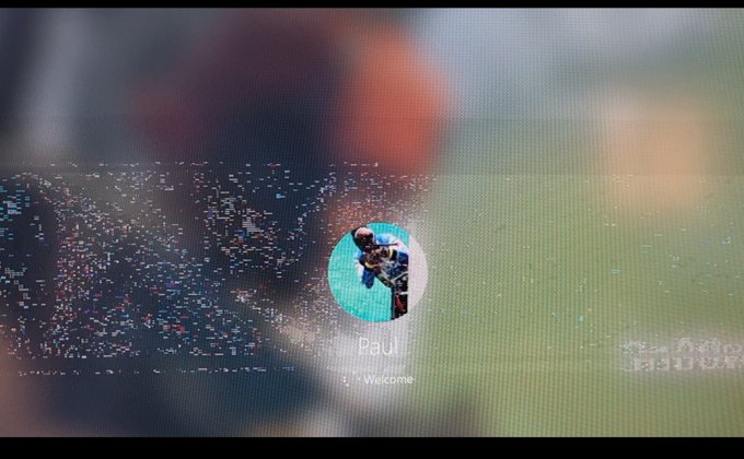

when I boot into windows as it goes from my loading screen to desktop for a split second I get a weird multi colour strip across the screen
looks like its make up of little boxes like a test page maybe started a few weeks back but noticed it was larger today about two inches across the screen
any ideas ? been getting the odd freeze in games as well was thinking that is heat related but runs fine if I turn avast of or seems to
Rx6700xt
Do you have any kind of adapter between the card and the moihtor?
ok then I might have resolved the weirdness did some trawling on tomshardware and reduced the windows refresh rate on the monitor down to 144hz this seems to have solved it on bootup
might also try a new display port cable , ordered a hdmi cable to try as well
will see how it goes in game
stopped the crashes now had my i5-10400f running at full tilt turned it back to normal and had one in 15 hours of game time
did get a decent hdmi cable but yet to try that and 165hz
turned out that was not the issue but all my crashing problems had been down to my system m.2 drive being on the way out (chances are it was corrupting files )
last time I use an old drive in a second build for the system
fresh windows install on a different drive sorted it the system drive bricked itself two weeks ago
its been good as gold ever since
