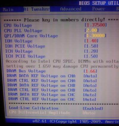

Got delivery of a shiny new i7 920 D0 this morning. Got into Windows @ 4.2ghz, and ran IBT on standard, five passes. Everything OK. Then I ran Prime for eight hours (blend). Everything OK.
....but as soon as I exited Prime (after running it for 8 hours), the entire system locked up. And now it won't boot at all at 4.2; gets half way through loading Windows and then blue screens. I've increased a couple of the volts a bit but I'm reluctant to do it much because they're pretty high already.
I also tried 20x210 which boots but fails IBT.
Does anyone have any ideas? This has really puzzled me.
These are the settings I'm using:
Do you have C states enabled? If so, turn them off, that might be the problem (if you have C states enabled then you're likely to get blue screens whilst idle because the voltage is lowering too much when it enters those C states to save power).
That seems to have proper sorted it, boots nicely and passes 20 runs of IBT. Cheers :)

Vcore voltage seem pretty high reflux, im no expert on i7 overclocking, but ive been tweaking mine this week at 3.8ghz (21x183), vcore 1.2750, qpi, 1.300, had a few issues on lower voltages on vcore /qpi, gave ioh, ich a rise to 1.2 which helped, theese chips run pretty hot. Any voltage i can keep to the minimum certainly helps.
