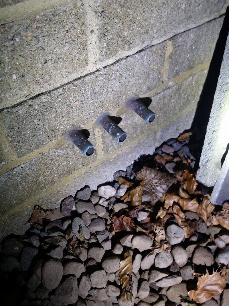

At the side of my house where the driveway is, I have these 3 pipes sticking out (roughly 3-4cm) low down:

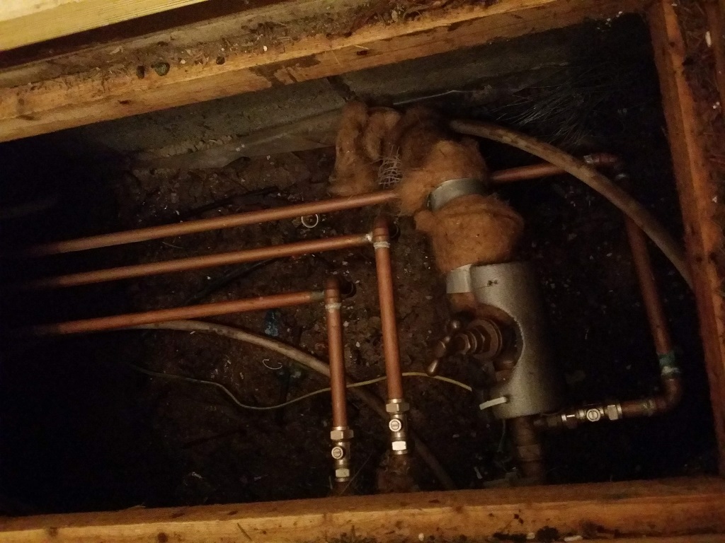

This is what the access hatch to the subfloor looks like:
Mains water supply (with the stopcock on it) is coming in from top of photo. The 3 pipes going off to the left are the 3 ends which stick out the wall. One of these comes from the mains, as can be seen in the photo. One seems to be from the hot water tank and I've no idea what the third is.
Has anyone seen this setup before and have any idea what this might be for?
It looks like one of them (the one from the hot tank) is leaking under the floor upstream of where the valves on them are but there isn't enough space for me to get down the hatch and investigate so I'm thinking of removing these pipes to give more room.
Drain for hot water tank
And drain for radiators
Would be my guess
The one off the mains is more
Puzzling

The one on mains feed is after
The stop not before it
So another drain

They are to drain the pipes as other have said.
Probably one for the cold feed, hot feed and the radiators.
If you didn’t have those drains it could cause havoc if you needed to leave the house empty for a winter (frozen pipes = burst pipes). Likewise it makes life so much easier when it comes to maintenance, you need drains at the lowest point to get it all out.

That would make sense that they are for draining the systems. I don't have any plumbed radiators or central heating so i guess it must be 1 to drain hot tank, 1 to drain cold header tank and 1 to drain mains pipework.
Seems like a useful thing to have so I'll either need to squeeze myself down the small gap or just remove them temporarily to get down there and sort the leak.

Can you see where it is leaking by looking through the hatch?
If so cut another hatch over the leak? :)
Yes, I can see it by looking through the hatch. It's only 2 or 3 meters away so I could get to it easily if I could fit through the existing hatch.
My floors are chipboard sheets rather than floorboards with laminate flooring on top so I think it would be less effort to remove the pipes to give me access and replace them when done.
I'm going to leave it with the water main turned off until saturday afternoon or sunday morning to give the ground some time to dry out before I go crawling around under there though.
