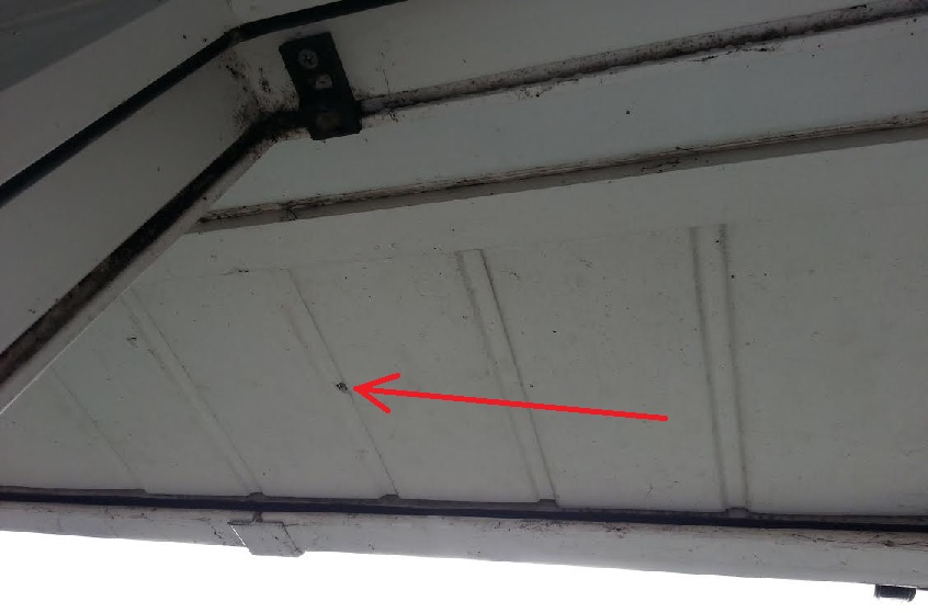

I'm installing an extractor fan in our bathroom and I want to exhaust the steamy air through the attic space and out through the PVC soffit board. So I went up into the attic to look at the position of the rafters and measure where the hole needed to be.
Then I get my drill out for an exploratory hole, thinking I can just get an electrician's fishing rod up the hole to make sure it emerges into the loft space.
However, when I drilled through the soffit board, I almost immediately hit wood after the drill went through the soffit board:
Have I hit a rafter? If I have, I can't see how as I thought I'd measured it! Are there any other possibilities? When I push up on the soffit boards, there's some give before it hits something fairly solid but I presumed thos was just the soffit mounting to the sides.

Maybe the old timber soffit if that uPVC has just been laid over it. Or maybe a substrate of board. I can't really see what that uPVC cladding is attached to unless there's something to bridge the gap between the rafters.
+1
Sometimes I've fixed a extra bearer to the trusses,etc, just to give upvc soffit a bit more support.
Nothing of importance there to drill into & damage.
No.
As your going to cut a 100mm hole, try drilling 25mm either side of the hole you drilled, as a joist is usually 50mm, should be able work out what your hitting & move your 100mm hole a bit this way or that way to clear it.
But, if you drill into clear space, measure 100mm from that hole & drill another hole just to make sure you have nothing else in the way & enough clearance for the pipe.
