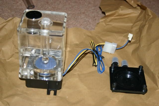

the wc loop will be in a corsair 750d case, will consist of one 360 rad in the roof(trying to decide if the thin xspc several year old rad(think its a rs360) I have is enough or should get a hardware labs black ice sr1 360), Maximus vi formula(has a built in block so may as well make use of it), 4770K(xspc raystorm block), sapphire 290x (ek fc r9 290x nickel(original csq), dcc-1 15w pump with res top.

As for the size of the res top, it's not that big

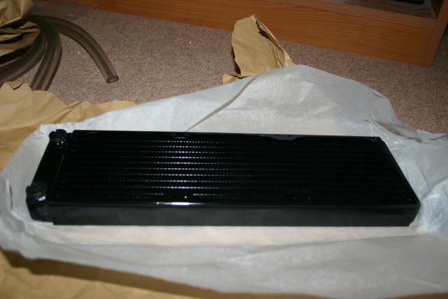

The rad I have at the moment
Will that be enough to cool a oc'ed 4770k(4-4.2ghz day to day use) and a oc'ed 290x(no idea how far it can go, not had the chance to test it, not going to high clocks tho)?
290x is a hot one!
I have read in this very forum that an 'extra' 120 is advisable per 290x (so 480 total), but YMMV obviously. I have no first hand experience.
You might get away with 1l. Could try getting some DI water and the dye/concentrate and slightly diluting it, but as with most things w/c, if it's worth doing then it's worth doing right.
