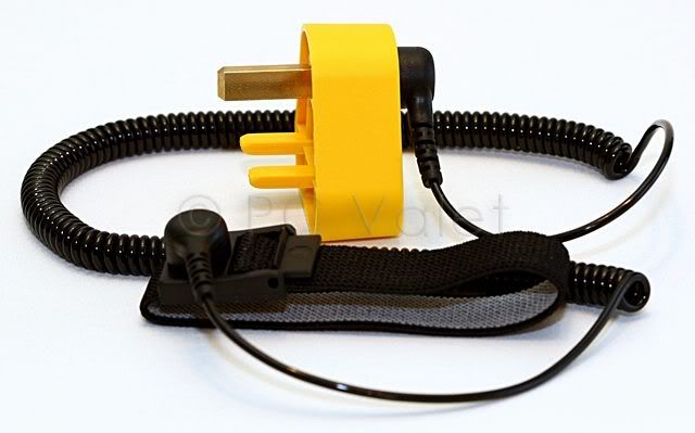

or get a dummy plug like the one pictured

Too late for that, I just got home from work and ready to build! :eek:
